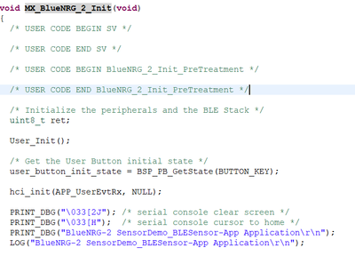

I doing the debug. I have attached on screen shot. This one only executing. Blnrg2 not show in st ble sensor app.
LOG("BlueNRG-2 SensorDemo_BLESensor-App Application\r\n");
Note that you can paste the image into the post - then we can see it in context:
But please don't post code as images - see How to insert source code.
So what is this LOG() actually supposed to do?
Is it a UART output?

Hi Andrew
Yes, LOG for debugging purpose.

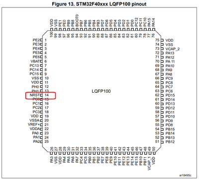

V = 100 pins;
T = LQFP.
So Reset (NRST) is on pin 14:
Hi Andrew
Can the NRST pin be used as a GPIO output pin (for Reset) in the .ioc configuration file? It is not showing up.

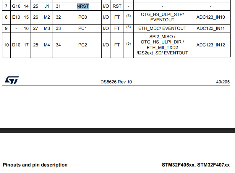

@Kumar123 wrote:
Can the NRST pin be used as a GPIO output pin.
No - see the datasheet:
https://www.st.com/resource/en/datasheet/stm32f407ve.pdf#page=49
via: https://www.st.com/en/microcontrollers-microprocessors/stm32f407ve.html#documentation
The configuration tools won't offer options which aren't available in the hardware!

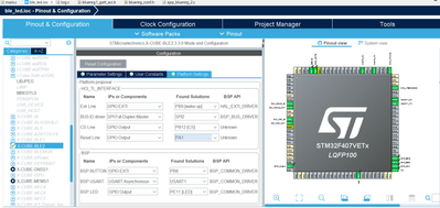

Hi Andrew
I have created the .ioc configuration as shown. Can you confirm whether it supports BLE? The file is attached.ble4.png
