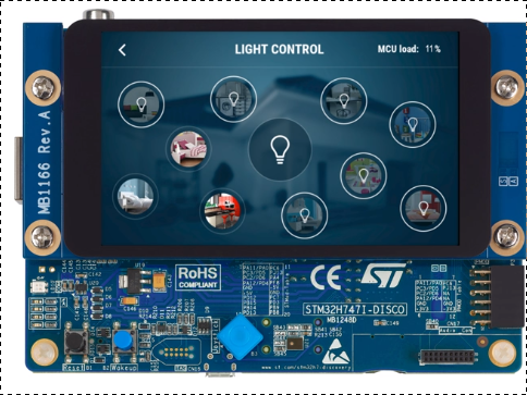

I got a stlm32 disco board. I cannot Flash.
So,I used STM32 ST-LINK UTILITY. Any connection fail even under reset. This one show Target Voltage Detection Fail. The board is powered by the USB CN2 Connector. The measurment on the CN4 Connector shows 3,3 v between 1 and 3 pins.( which seems normal)
Could this be a software issue ?

what board/cpu ? which st-Link ? which lines connected or onboard ?
try: STM32CubeProgrammer ,
ST-LINK UTILITY is outdated.

My board is stm32h747i-disco which include theST-LINK .
Following your advice, I used the STM32CubeProgrammer.
I did a succesfull upgrade firmware but connect failed.
Report is: Error: No STM32 target found! If your product embeds Debug Authentication, please perform a discovery using Debug Authentication.
I try to understand this ??
Best regards,
AScha.3
so you have this ?
_legacyfs_online_stmicro_images_0693W00000bkZ8kQAE.pngis the demo running ?
_legacyfs_online_stmicro_images_0693W00000bkZGiQAM.pngled8 ON ?
jp3 ?

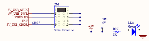

  1. Bridge shoud be between 1 an 2 on JP6. This the case
  2. I try bridge or no bridge on JP3. Same result
The green led D8 is on.
After that, I still have the same error on stm32Cube programmer. I cannot flash anything. So no demo

JP3 bridge + check voltage on it, is CPU vdd .
+ But nothing getting hot??
BRobe.3
Voltage on JP3 bridge is 3.29 Volts. Its fine.
I doesn't detect hots points.
AScha.3
and at R83 :
here stlink checks voltage...should be 3,3 + 1,6 V .. about.
