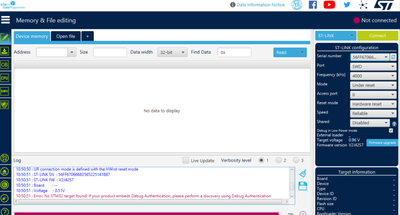

I have designed a custom stm32 board in order to detect my stm32 by the computer for the code uploading i connected my stm32 externally with a TQFP breakout board with my ST-LINK V2 , all the necessary connections have been made after that when i try to connect it on stmcubeide i shows can not connect i tried it with stm32 utulity software as well same result arise.
when powering my stm using st link or external power all the vdd pins are getting 3.29v while the vcap is 1.2v and 1.6v (2.2 uf capacitors) .

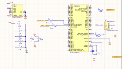

in this picture ignore all the connection except power and swclk and swdio connection...

the actual circuit is a bit messy because of a number of testing but let me show you and explain it:
    STM 32                                                     ST LINK V2
 pin 55(SWO)  connected via 22ohm --->    SWO pin 13
pin 7 (NRST) connected via 22ohm + 0.1uf -----> PIN 15 (RESET)
Pin 49 (SWCLK) via  22ohm                  ----->  pin 9 (SWCLK)
Pin 46 (swdio) via  22ohm                  ----->  pin 7 (SWDIO)
VDD+VDDA+VBAT (3.3V) ----->  pin 1 (VCC)
GND ----->  pin 1 (GND)
pin 60 (BOOT0) connected to ground directly
VDD CONNECTED VIA 0.1uF AND 4.7uF AT ONE VDD
VCAP CONNECTD WITH 2.2uF
unfortunately there is a voltage drop at the vcc of the stm32 i guess something with my vcc connection is wrong.

So you can see the ST-LINK in Device Manager now?
You need Target VCC connected to the ST-LINK/V2 to power the IO buffers. Would suggest VCC GND SWDIO SWCLK NRST
You should double check your supplies and grounding. Both VCAP pins should be the same, around 1.2 or 1.25V

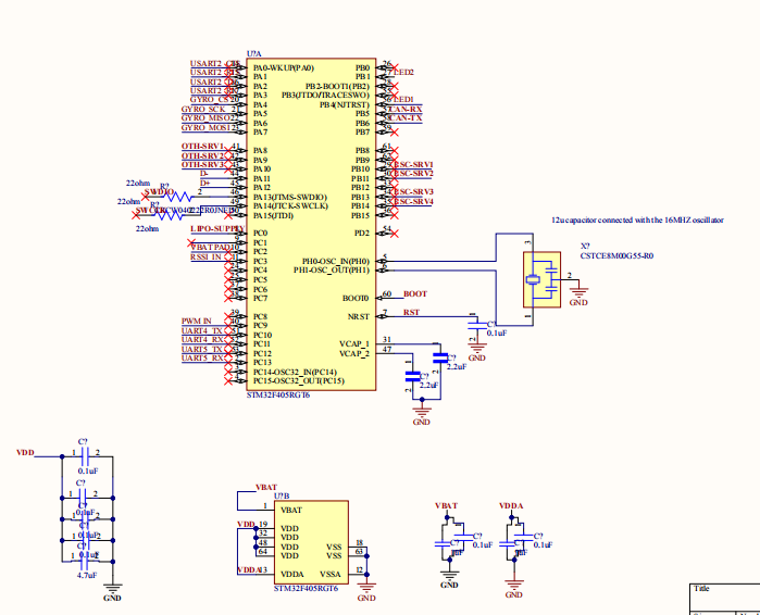

Yes i can see the st-Link v2 in my device manager and although i have connected the vcc of the st link to my vcc of the stm32 pins and other connection like you said as well i have checked by giving external supply also its showing 3.3v at each vcc pin but when i connect the circuit using st link to my computer on stm cubeprogrammer this stuff is making me triggered why that voltage is less? here is my circuitry schematic between st link and stm32

Firstly, you should update the rather old firmware on the ST-LINK/V2, which you can do directly via the STM32CubeProg.
Then the CubeProg will show a lower voltage because it measures - or thinks it measures - this voltage on its VDD pin from the target. Assuming you have connected VDD and GND correctly (and therefore only read to the end), your ST-LINK could also be damaged. For this reason, it would be very useful to connect a KGB (Known Good Board, e.g. a NUCLEO) to check the ST-LINK/V2 for function.
But I am sure that you have connected your ST-LINK incorrectly: you think you have connected the blue wire on your photo to pin 1 of the 20-pin connector of the ST-LINK, right? In fact, it is pin 19, as you can see in fig 10 of UM1075. Please check this again and connect the wires correctly.

As you said and manual too pin 19 is vcc but i have checked my st link pin by multimeter it shows no voltage (in milli) in my st link v2 only one pin is giving 3.3v which is the pin 1 of stlink ? is it possible not my connection but my st link is not working properly?
