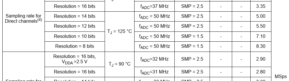

I want to achieve 7.5msps using three 2.5msps external ADC with interleaving method
Why not use the 16bit ADCs on-chip ? Can do 14bit at 5msps  - each ! So up to 15msps possible .
