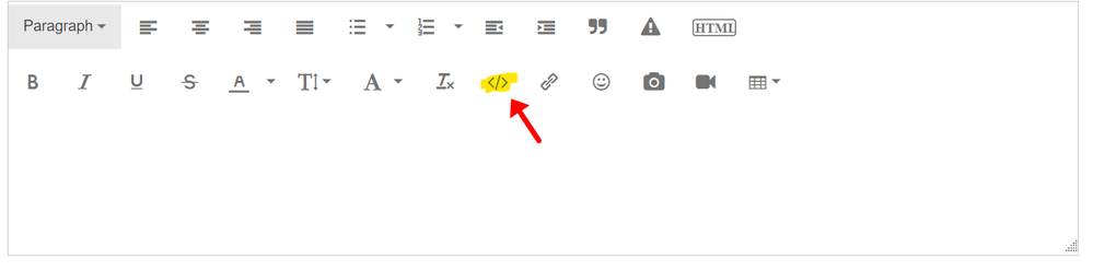

‎2023-11-16 8:09 AM
Edit your post and use Code Sample so it formats your code which makes it easier to read your code
TimerCallback tutorial! | UART and DMA Idle tutorial!
