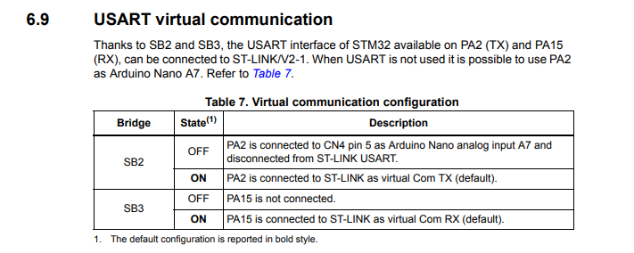

The STM32F042K6 has been giving me issues lately when it comes to using the UART module. USART1 is not working and USART2 only transmits. Has anyone encountered the same problem? I have attached a sample code I was using to test USART2 for both transmission and reception.

bongumsa12
By default, cubeMX assigns USART2 Tx and Rx to PA2 and PA3. According to the STM32 manual, for virtual communication (USB), only PA2 and PA15 are used. I had to change PA3 to PA15. Now the program works.
18 REPLIES 18
What board is this? How are USART1 and USART2 connected externally? Where is the signal on UARTx_RX coming from? Your code doesn't do anything with the received data. How do you know it's not working?
Probably a hardware issue. Either the pin isn't connected, or the signal isn't coming in where you think it is. Or possibly a misunderstanding of what should be happening.
I'm using the STM32F042K6. The received data is transmitted back through the same UART module. That's if there's any received data. The program for that is inside the main function.
Those are blocking functions. If you want to receive at the same time as you're transmitting, you'll need to use HAL_UART_Receive_IT or HAL_UART_Receive_DMA.

HAL_UART_Transmit(&huart2buffersizeof(buffer), HAL_MAX_DELAY) do not need interrupts to work. As soon as data is received, the HAL_UART_Recieve function stores the received data in the buffer. The program then executes the HAL_UART_Transmit function. I think the problem has to do with solder bridges or the UART modules are faulty.

I think you are ignoring the fact that the UART_MAX_DELAY flag is used in the program to block until there's data recieved. That's what I want to do. I want to block until the UART recieves data.
If RX and TX are tied, as you said, you absolutely do need DMA or IT to work. Otherwise, your receive function blocks waiting for data and your transmit function never gets called. Debug your code, hit pause, see where it's waiting.
