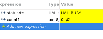

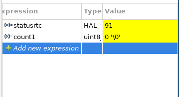

I'm using the latest of STM32CubeIDE. to program my STM32H750VBT6 created by WeACT. I've created very simple program that consist of I2C from DS3231 RTC and simple counting with the code below
HAL_GPIO_TogglePin(GPIOE, GPIO_PIN_3);
statusrtc = HAL_I2C_Mem_Read(&hi2c2, DS3231_ADDRESS, 0x00, 1, get_time, 7, 1000);
HAL_Delay(500);
count1 = count1+3;
HAL_Delay(100);
The problem is, the count1 is not counting, but the count goes to statusrtc. I realize the statusrtc give the HAL status (like HAL_BUSY, HAL_TIMEOUT) after the counting is done (>256 because count1 is uint8_t). What actually going on with my device? Or it is the bug of STM32H7 in CubeIDE?

Hello @zahrayudha ,
The same issue was already reported through this Post.
Make sure you select the same number format for both Expressions and Live Expression views to get an even presentation.
A solution for that problem was already published by @Makk :
Step 1) Close the Tab of the Live Expressions.
Step 2) Right Click on Project >> Select "Clean Project"
Step 3) Build and debug
Step 4) Select the "Live Expression" from the windows tab
Thanks.
