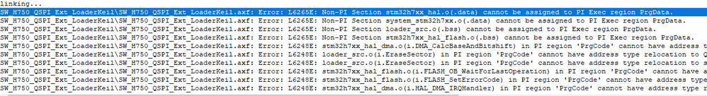

Unfortunately, the Keil example is given in examples also can't work, it gives lots of errors while compiling, also the project settings in some examples is default settings of Keil, they have never been changed. I tried to generate myself a new project and set both the settings and the linker file as in another Keil example, at this time get the linker error. I'm confused about this problem and the project can't move forward.
Linker Error:
The Linker is given in examples :
FLASH_LOADER 0x20000004 PI   ; FlashLoader Functions
  PrgCode +0           ; Code
    * (+RO)
  PrgData +0           ; Data
    * (+RW,+ZI)
DEVICE_INFO +0               ; Device Info
  DevInfo +0           ; Info structure
    dev_inf.o
I've used this
DEVICE_INFO 0               ; Device Info
    dev_inf.o
FLASH_LOADER 0x20000004 ; FlashLoader Functions
  PrgCode +0           ; Code
    * (+RO)
  PrgData +0           ; Data
    * (+RW,+ZI)
