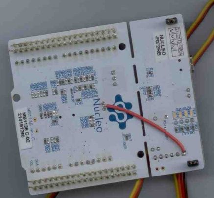

I modified some Nucleo Boards in order to have a powered programming adapter. The target there needs to be powered through the Voltage Regulator of the User Part, otherwise USB connection is lost when attaching your target device. The STLINK V2 adapter does not supply your target unless you do it yourself using a seperate 3.3V source (good old manual patch work). The internal source normally also suffers from the USB lost problem. Using an old Keil ULINK ME Board in a different setup was ok with an additional 1000uF Cap across 3.3V local power supply.
Regards
Werner

@Werner:  I should clarify that I'm talking about the standalone product - as described in the mentioned User Manual - not the integrated things found in Nucleo & Discovery boards.
