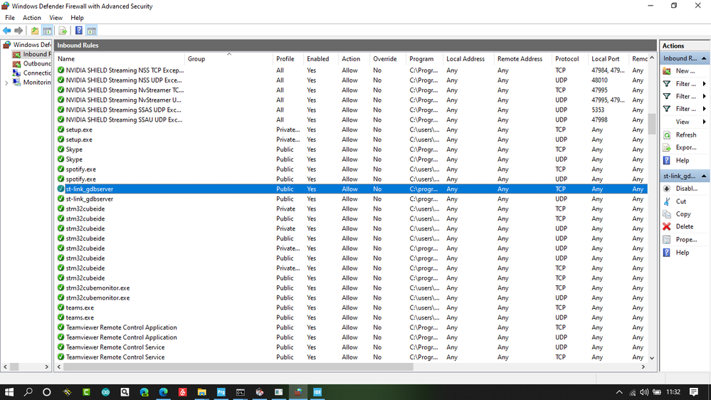

install latest gdb server software. Open firewall settings go to ibound connections and check if st-link_gdbserver is enabled. Check all the rules that contain gdbsever and enable it to allow connections for private and public networks

well here it shows two labels with st-link_gdbserver and one of them was disabled, so I enabled that one.
can u tell what do u mean by check all rules of gdbserver???
after enabling, I restart my STM32CubeiDE and debug the application but still showing same error.
