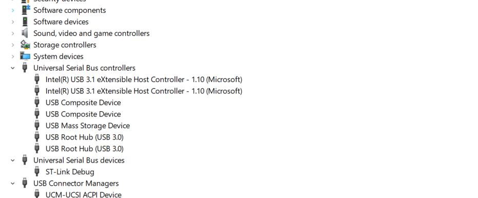

The strange thing is that if I do not do Help => STLink upgrade every time. It shows no stlink detected. And each firmware update only valid for 5 to 10s for me to debug(which can find the stlink and run on nucleo board). After that, I have to start the whole process again like, unplug usb, plug in, quickly open firmware update page either on cubeIDE or cube programer or utilities. I think it is my laptop issue since I have tried changed cables, new nucleo board etc. but I checked all my computer usb driver is up to date and the st debug server is all up to date.
LaurentL
January 20, 2021
Try to use the installer to install the STM32CubeIde (v1.5.1).
It will install the STLink usb driver (though you have them already with v1.3.0 install) and the latest STLink server tool and then you should be able to debug.
Check the usb cable and also the usb connector, maybe there is an issue on the USB connector of nucleo board ?
In Windows Device Manager, If you can see the STLink debug in USB devices, it should be ok.
What you could do also is to install STM32CubeProgrammer and mass erase the device to be sure you don't have an application code messing with the board.
Rgds,
Laurent

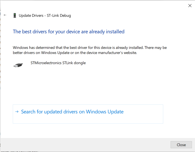

yunia.3
yunia.3Author
January 20, 2021
yunia.3
yunia.3Author
January 20, 2021

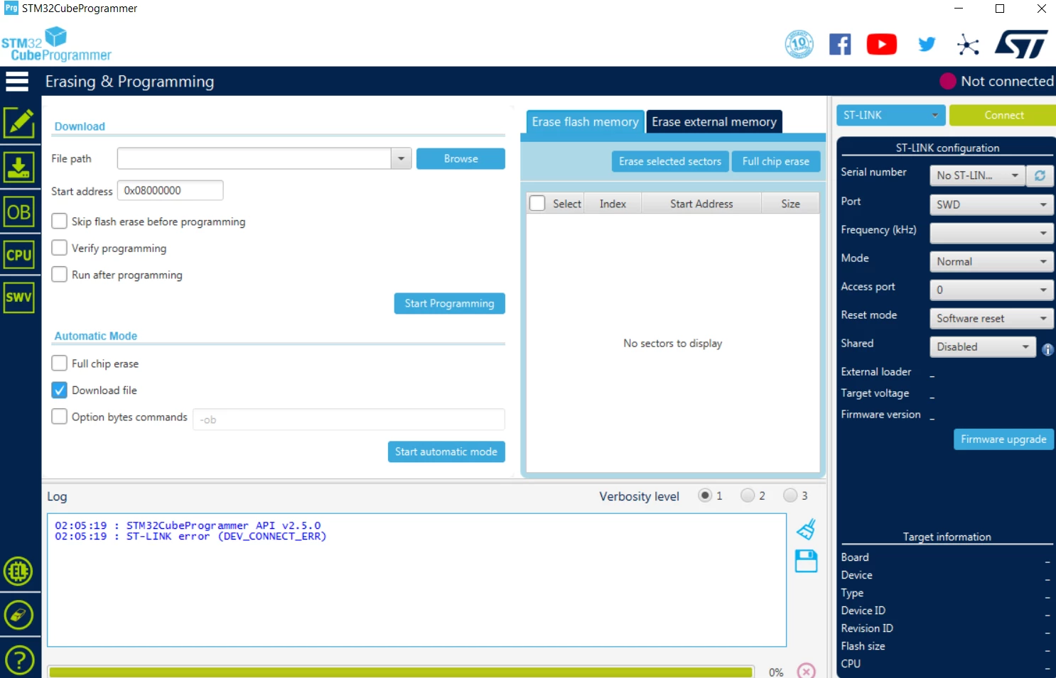

I did used the installer to install the STM32CubeIde (v1.5.1). And I have to used the above process to debug otherwise it always shows No ST-LINK detected.
I checked and I know it has latest STLink server tool but I think on my laptop is not working. I changed several usb cables and I just bought a new nucleo board and still not work.
In Windows Device Manager, I can see the STLink debug in USB devices, but still not work.
I tried to manually search for the driver in ST folder and it cannot be changed.
In STM programmer, I have to do the same thing to be able to find the board: quickly install the usb and click "firmware update" and it can be detected for just several seconds. Btw, How do I mass erase the device?
LaurentL
January 20, 2021
Mass erasing the device can be done with the eraser (bottom left button).
I suggest you to connect with hardware reset and connect under reset.
But you must solve your stlink issue first I suppose.

Hi
I tried a lot of times, only first several seconds can detect the st-link on Cube Programmer. And every time if I want to fix this, I have to plug in the usb and quickly open the firmware upgrades in CubeIDE or Cube programmer, and do the upgrade. After upgrade, I have to debug within several seconds to be able to find the st link. After several seconds, when I try to debug again, it losts st-link and shows the message again:No ST-LINK detected. I changed a laptop but still using thinkpad and does not work. All the usb driver is updated and the st0link debug can show in the "device manager". Where to find the two jumpers for STLink debug should be on in device manager and what are the names for the two jumpers
LaurentL
January 25, 2021
I was talking about the 2 jumpers on the Nucleo to debug the mcu but it is not on all nucleo boards.
And if you can debug, they are ok.
If you can see the stlink for a few seconds, maybe it is the overcurrent limitation (PC shuts down the usb port).
Try to boot in bootloader mode to erase the device with CubeProgrammer.
To do that, you should set the Boot0 pin to VDD with a wire when you supply the board.
Boot0 pin is available on the headers.
After mass erase, you can remove the wire and reboot the board.
Rgds,
Laurent
