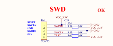

So, just to clarify jumper 1 short across 1 and 2. When I plug in the st link into the pc do I connect the cables as per diagram on the outer case? Rst to rst, swdio to swdio, etc? Also, I send the geode files via Ethernet using an Arduino uno board with Octaprint

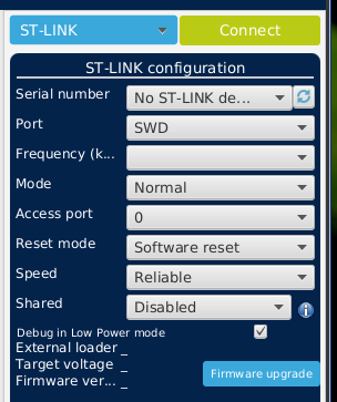

No - if you have a (working) st-link, you can connect to J44 , swd port.
no need to set boot jumper !
You only need connect : swd, swc, gnd .
set CubeProgrammer then to : st-link, connect normal,  software reset.
You have to see : st-link serial....then try : connect.
get you connection ? Then can upload/flash new software.

Do I need to have the skr motherboard powered ?
No power, no fun. (But just the cpu, not the motors etc.)
Maybe (!) , just giving 3v3 from st-link is enough - try it. (to vcc 3.3v ) (dont connect 5V here ! Kill cpu ! )
The pinout here...i cannot understand, something wrong: pin1: seems vcc 3v3, pin2 : swd , 3: gnd, 4 swc, 5 trst.
But left writing is totally different... so whats real ? Best: check -un-powered- with a DMM, where is gnd and 3v3.
To see: what writing is real.
