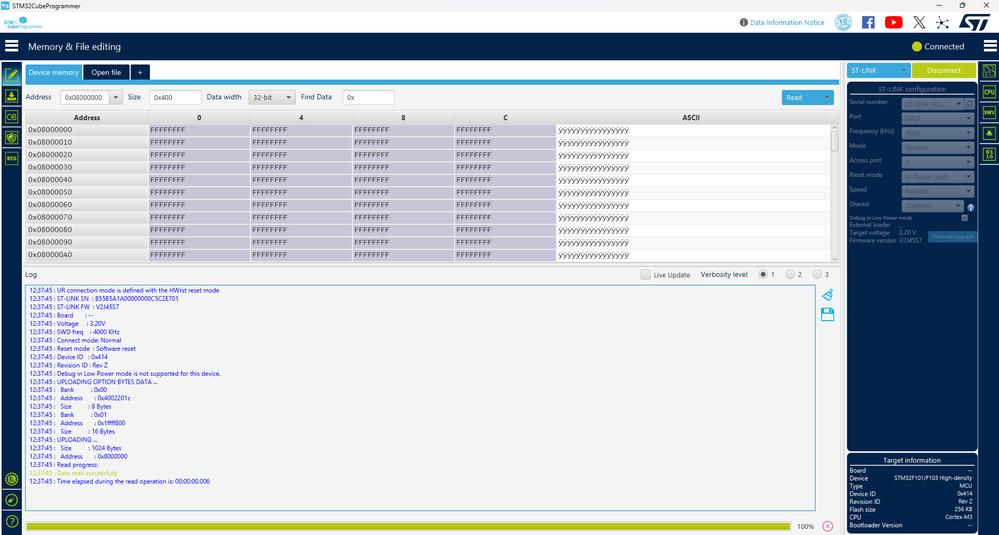

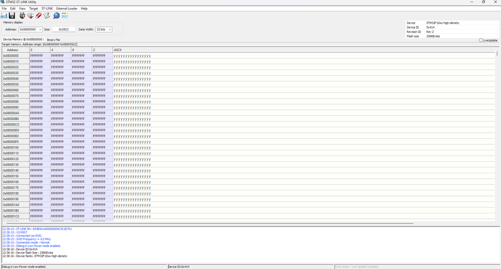

Recently i bought this STM32F103C8T6 Board along with ST Link V2
I was trying to upload a HEX(60KB) file using STlink software but i noticed something wierd, memory size in both pics is showing 256KB but this device only comes with 64KB flash memory then how is this possible?
Product Descriptions says 64KB Flash Memory
Honestly i am confused

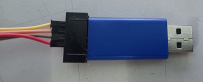

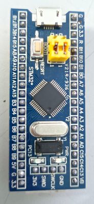

Could you please insert a photo of your ST-Link V2 (back and front) and your board?

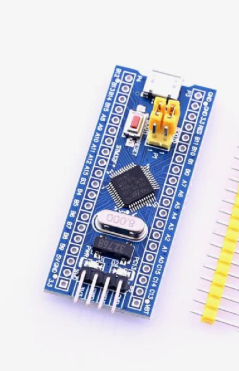

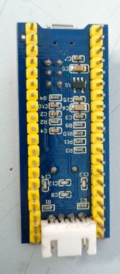

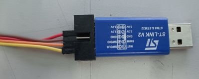

Hi thanks for reply!
Sharing what you asked also providing some more info on what i am trying to do
I am building DIY FFB Steering Wheel using two boards STM32F103C8T6 Work as wireless transmitter paired with NRF24L01 on the other hand Main board STM32F401CCU6+NRF24L01 (Input hardware working fine just both boards not connecting wirelessly
Firmware on STM32F401 is working (Uploaded via USB not stlink).But this STM32F103 is causing issue most probably as i am unable to identify if the firmware is uploaded succefully or not.(How to check occupied flash memory on stm32 boards?)
Moreover i am adding Video how i upploaded HEX file using St Link
(Boot 0 Heander is on 1 position // Boot 1 Header on 0 Position)
photo_2025-06-19_22-04-10.jpgphoto_2025-06-19_22-04-15.jpgphoto_2025-06-19_22-04-18.jpgphoto_2025-06-19_22-04-20.jpg
Probably fake or counterfeit parts.
The ST-LINK you picture is not authentic.
The Part# on your Blue Pill board is not readable, you might try using macro mode to get a close and in-focus image.
The Size of the FLASH is reported by a memory location within the IC, the programmer software reads that and displays the value. Suggests this started life as something other than a STM32F103C8T6

It's either a counterfeit part as @Tesla DeLorean mentions or the actual part number STM32F103C8T6 in the description is not correct.
So instead of STM32F103C8, it maybe another part, like a STM32F103RC, which is a 256KB part
Edit: Actually the RC is a 64pin part so that wouldn't be the case.

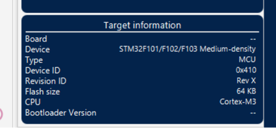

When using a real ST-LinkV2, I get the correct flash size of 64KB for my blue pill. It also shows it as a Medium density part. Your screen shot shows high density, so something doesn't add up.

I don't think the 256KB Flash was offered in the 48-pin QFP, although the die is about 4.4x4.4 mm

Hi, @Titan ,
Unfortunately, it's a blue pill with a counterfeit chip.
I accidentally had a few of them, and they are going to give you problems.
The STM32F103C8T6 isn't the real deal. It has 64kB of flash memory but it has many issues.
Some of the problems I had include:
- It doesn't have 5V-tolerant pins. The original does
- SPI bus fails at high speed.
- In one unit I needed to push RESET button every time I powered the chip.
- ST does not want to program counterfeit chips or use of non-original ST-Link
The ones I had were labeled as genuine, but they obviously weren't.
