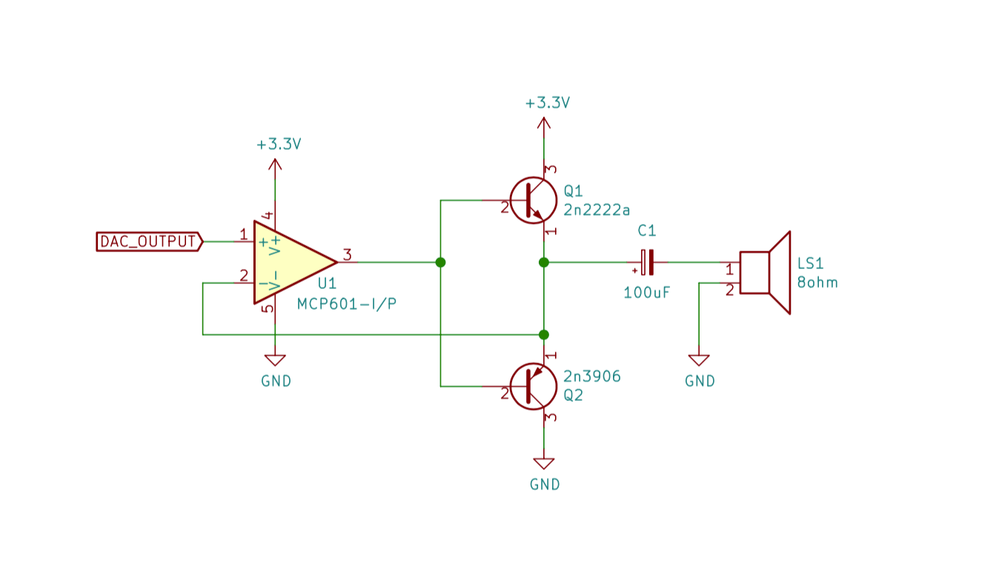

Hi, I am using the STM32H563ZIT6 microcontroller and trying to interface it with an internal DAC to a speaker through an external MCP601 op-amp. I am generating a sine wave on that DAC pin, but it is producing some noise in the speaker. I am unsure how to properly generate sound with the speaker using the hardware setup shown in my connection diagram. Can anyone please advise me on how to generate sound on the speaker using the hardware setup below?
Note: Small correction: We are using 5V for the speaker; the remaining setup is unchanged.op_amp.png

Looks dangerous, without any resistors in there...
Anyway, can you see the DAC signal at the opamp input?

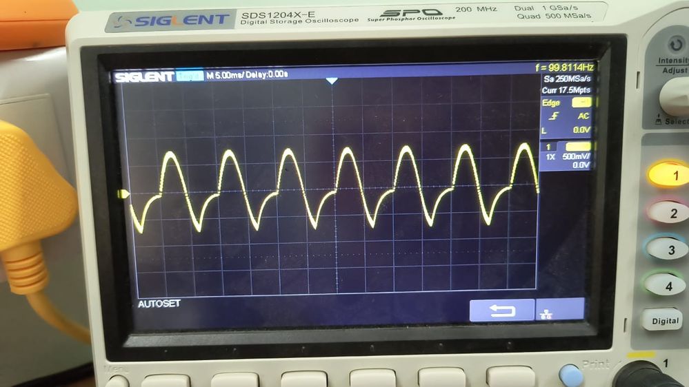

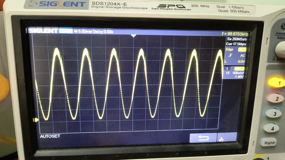

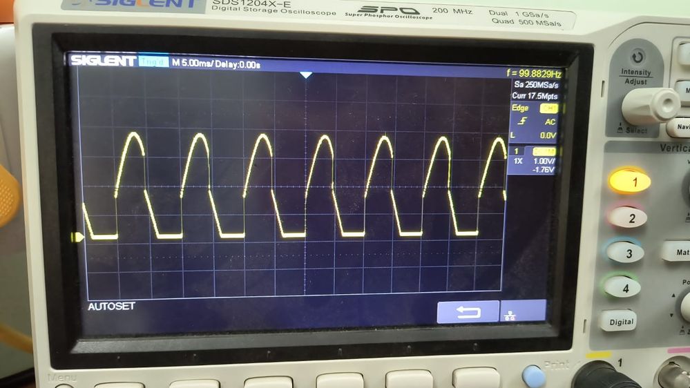

internal DAC output wavesinternal DAC output wavesOP-AMP OUTPUT SIGNALOP-AMP OUTPUT SIGNALSpeaker input signalSpeaker input signal

No need to look at the code, this is an analog problem.
I never used this analog push/pull output with such a low voltage and single supply.
The only thing you should change in the code as a start:
reduce the sine / DAC's output level, so that the sine wave is somewhere between 1V .. 2V.
You cannot expect all levels to be clean between 0 and VCC, especially with "power" output, which it is, driving an 8 Ohm speaker.
I usually put some resistors before the transistors' base.
But I still think that the low voltage and low impedance are the biggest problems here.

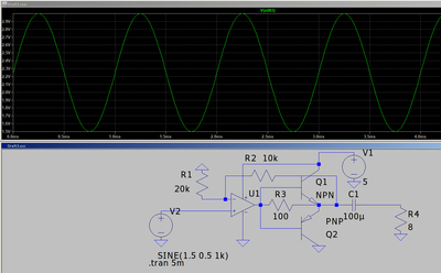

I forgot: a good example to use some PSPICE / simulation in advance.
AScha.3
You should use an amp, thats working at low voltage, like : TDA1308 , or TA8227P , etc.
Here add a 100 r resistor and a little gain+offset , + opamp at 5V ,  to get some signal :
But dont expect wonders... :)

Some addition to what @LCE and @AScha.3 said:
With your schematics, it doesn't matter whether you supply the transistors with 5V or 50V - it's a voltage follower whose gain is only theoretically 1, but whose output voltage corresponds to the maximum input voltage, reduced by the two base-emitter voltages. At full level at the input with 3.3V you will therefore only get a maximum peak voltage of 3.3V-1.3V=2V, which corresponds to 0.71V rms voltage - which even at 4ohms only produces a quiet whisper.
I would also suggest using an integrated amplifier instead of such discrete contortions, e.g. the TS4890 or TS4990, both of which can work with both 3.3V and 5V.
Few notes:
MCP601 input common mode range is VDD-1.2V. That means you should input only voltages up to 2.1V from DAC.
Second scope trace (OP-AMP OUTPUT SIGNAL) should be measured with DC coupling - something smells there, because you measured about 3.6Vpp at 3.3V powered opamp output...
