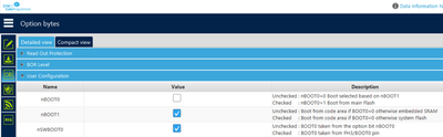

I found that in my P-NUCLEO-WB55 kit, the Boot select bits in the Option Bytes were not correctly set.
This works for me to boot up in DFU mode:
You are a life-saver, thank you for that.
Now I can boot into DFU mode normally.

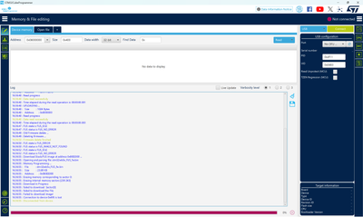

Hello @majidsurefow

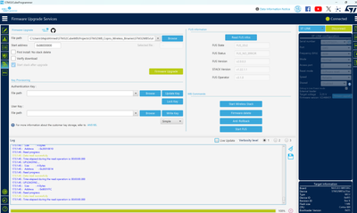

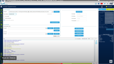

Could you please state the exact steps (with screenshots if possible) on how you have done this update. and a final screenshot similar to this one:
Best Regards.
STTwo-32

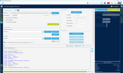

Thanks for your reply.
I am currently using Firmware 2.0.3

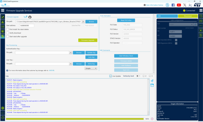

Here is a screenshot of what I get if I am using the DFU-USB Interface to check the FUS status:
I am currently using FUS 2.0.0.3 as I have installed it blindly while trying to upgrade my BLE/ZigBee binary. The STM32WB_Copro_Wireless_Binaries directory I am using is the one that results from cloning the https://github.com/STMicroelectronics/STM32CubeWB/tree/master  repo.

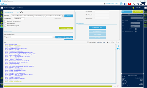

Here is a screenshot of what I have after deleting the firmware:

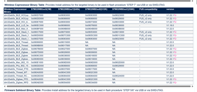

I am setting the starting Address to 0x080EE000 as stated in the release notes, and attempting to flash the FUS binary:

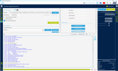

Next, I tried flashing a random file which was the stm32wb5x_BLE_HCILayer_fw.bin:
This is the only one that flashes correctly. If I try to flash something else, lets say stm32wb5x_BLE_Zigbee_FFD_static_fw.bin, here is what I get:
The device disconnects mid-flash, and I have reconnect it using the GUI option.
