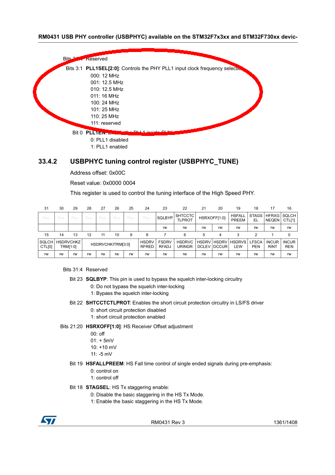

They already answered, that clock is selected HSI (16 MHz - F723), and 8 MHz is HSI/2. This makes me wonder, why someone would select 16-HSI if there is 25-HSE and according to picture it's supported by 101 bit settings.
One word, backward compatibility. Okay that's two words. There's probably too much example code out there depending on the 8MHz, even if nonprecise. And probably no-one knows, how much and where exactly this dependence exhibits itself.

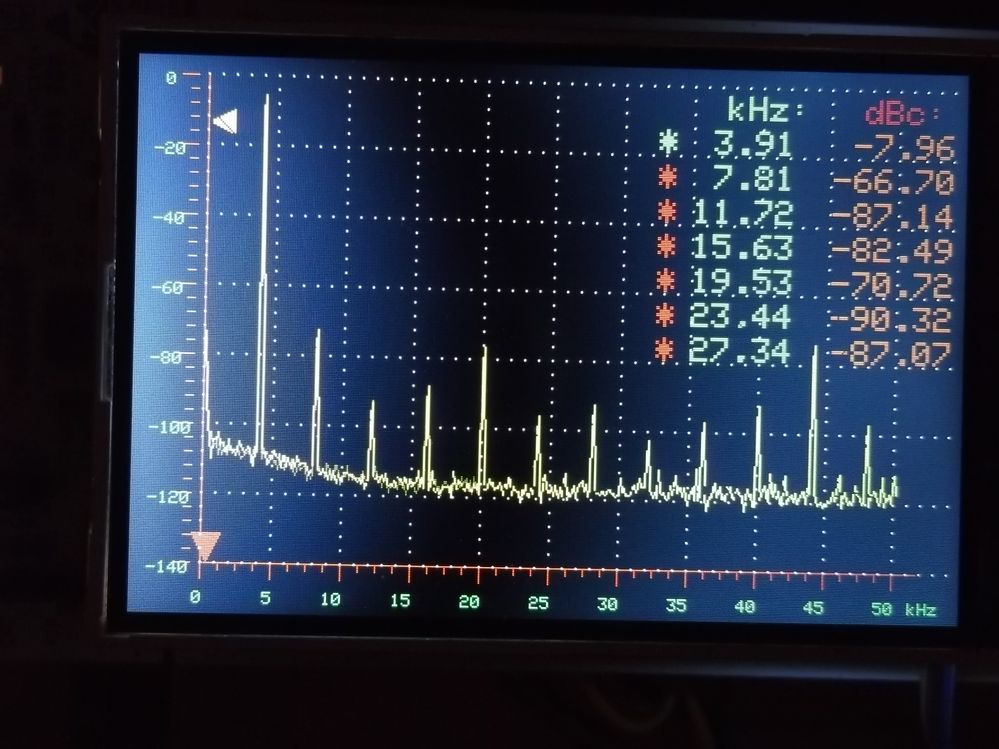

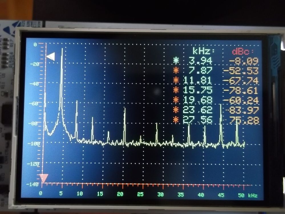

For now I brought 50 MHz from SB57 to SB45 (two pads in close proximity, jumper removed on SB45). Here is the difference:
SA is custom made, still good for "comparative analysis" as long as two pictures taken with exactly the same settings. Picture shows sine signal obtained out of DDS on H743zi2 (two DAC simultaneously 20-bits resolution).
