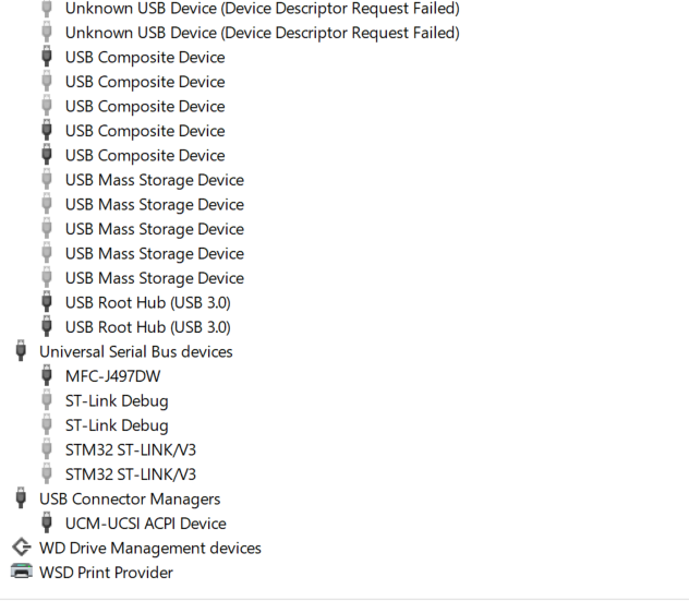

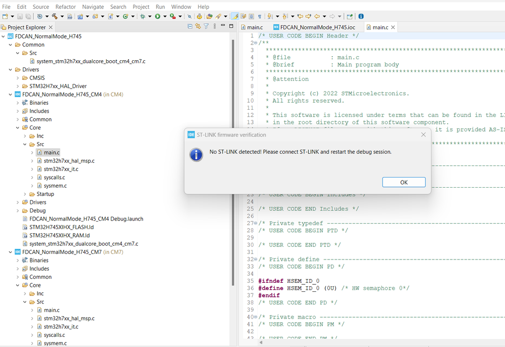

Software side -IDE,MX  files  okay  except when I get to debug configuration - Error" no
st link "   drivers exist in Device Manager  ; hook up to power CN15 on H7451 ; Windows 11 system
Downloaded St link 0009 latest - followed wizard  everything okay; ( maybe it matters what directory the  amd64 is in ?
Help?
DebugFDCANH7451NORMALMODE.pngSTMH7451boardpowerconnect.pngBUSDRIVER.pngST LINK 009.pngST LINK 009.png

This board has on-board ST-LINK. There are some badly detected USB devices in the dev. manager. Check the  USB and power cables. Check the board connector and any jumpers that can affect ST-LINK or power supply.

Oh nevermind, you clearly have a genuine ST board. The part about trying to connect with STM32CubeProgrammer is still relevant.
You need a programmer to program. The IDE says it can't find one.
STM32CubeProgrammer is the software that is used to connect.

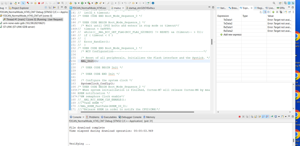

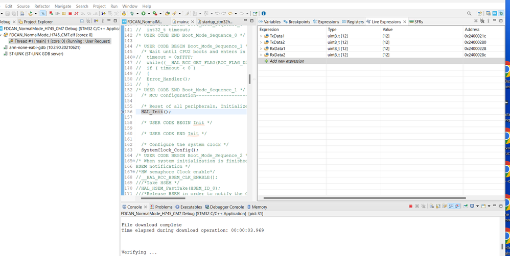

However "  in main.c   cm7 after  creating breakpoint at line 156 like the ( see below pic"s for  remaining text) ErrorTargetNot AvailbleResumebuttomH7451FDCANNM.pngErrorTargetNot AvailbleResumebuttomH7451FDCANNM.pngLiveexpression.png

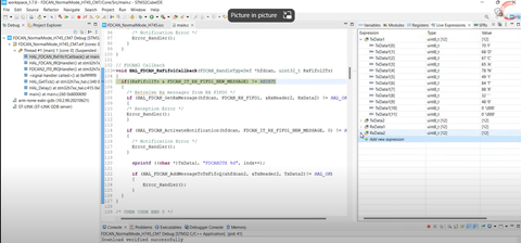

video and populating the " expression" then hitting resume button  - no response - see attached   - can't create the  data  like that in the video - last pic
Any guidance would be appreciated. I'm powering thru the CN14 SLTK /USB connector so far so good up to that point
