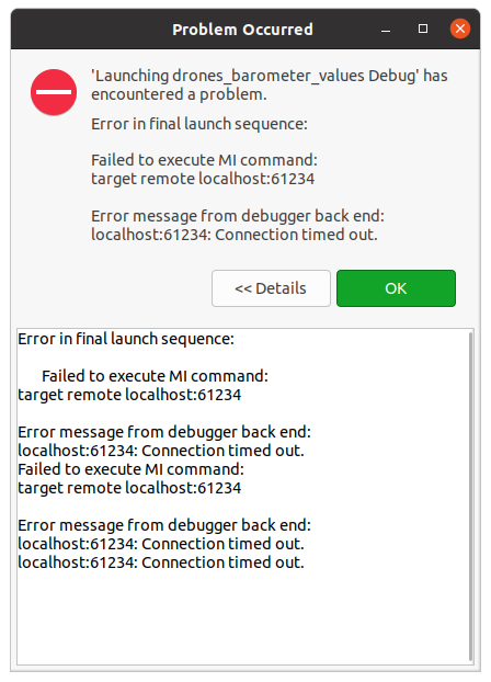

Additional to this there is an another dialog box arises when i debug or run the code. Screenshot from 2025-06-03 16-30-38.png
 what are the reasons this might get

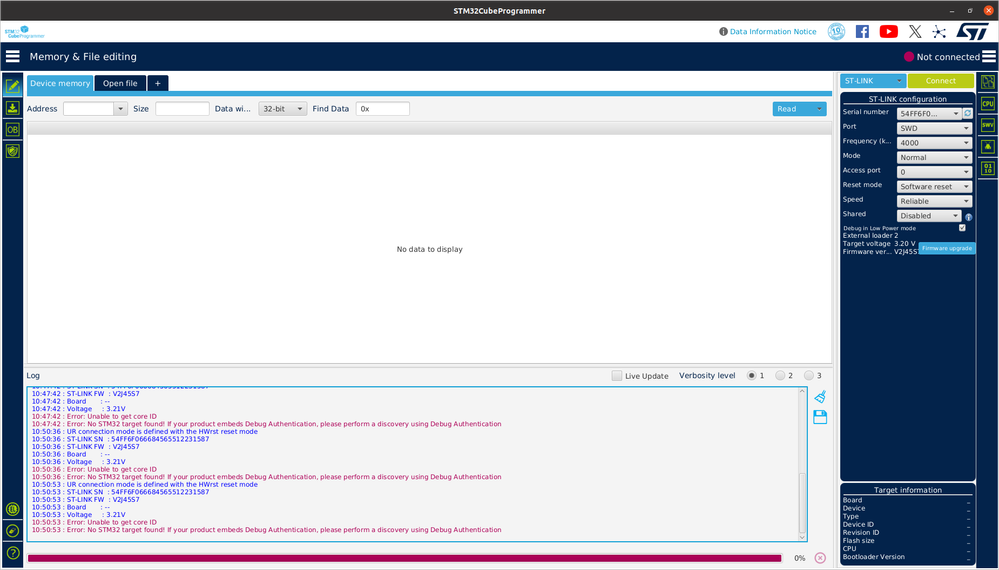

Can you connect with STM32CubeProgrammer?

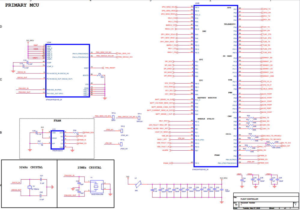

Can you show the board schematic? Could be a design issue.

Put the chip into bootloader mode and then try to connect (in STM32CubeProgrammer).
No im unable to connect with stm32cubeprogrammer
i discuss with the hardware designer and send the design

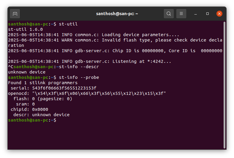

and now i connect it to through stlink commands in linux terminal. shows chip id and core id as 0.
is it due to its not recommended for new designs as they said in their website. https://www.st.com/en/development-tools/stsw-link004.html

yeah here the schematics

but im unable to connect with stm32cubeprogrammerScreenshot from 2025-06-04 10-59-09.png
