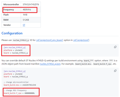

According to the boardlist at plattformio i cant see that STM32H745 is supported though? Are there an alternative?
https://github.com/platformio/platformio-docs/blob/develop/boards/ststm32/nucleo_h745zi_q.rst
Meanwhile, there is config problem. As I said, in SMPS System clock should not exceed 400MHz @VOS1:
I don't have an idea how PlatformIO works but you need to change the frequency to 400MHz and the voltage scale to VOS1
