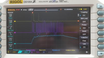

Also I dont know why is the voltage levels of the clock seen as 30V ?
I am not even supplying the same

If you don't tell us which SPI signals we see, the picture doesn't help much.
30V: scope thinks probe is set to 10:1, but probe is set to 1:1.

Yeah my bad but a very queer thing happened. I am getting 0xFFs on the SPI5, SPI4, SPI3 but when I connected the sensor to SPI1 the code worked without change in any logic just the name of the SPI. That I dont seem to understand. Atleast the sensor is responding. This happened on a NUCLEO.
Also the the same is happening on a custom board as well. Cant understand this occurence.
Can anyone point me to the pertinent registers to look at which can help in the debugging.
