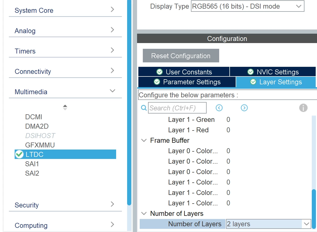

I am trying to create a basic setup for  STM32L4R9-DISCO with CubeMX and TouchGFX.
TouchGFX complains about more than one layer being active from the LTCD module.
But I cannot figure out how to disable a layer in the LTDC.
MM..1
Chief III
Simply open MX click ltdc and switch to one layer mode

tkorsdal
Thanx! How was I able to overlook this :)
