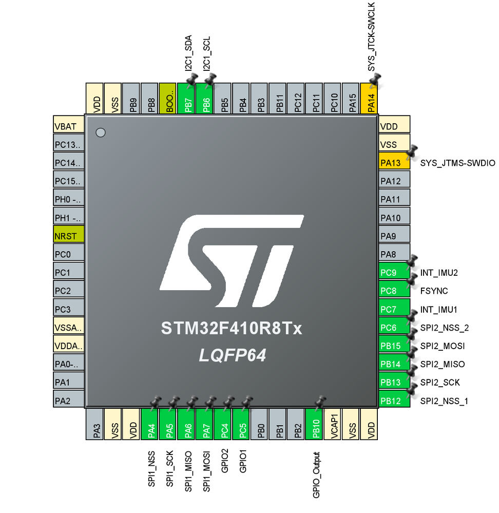

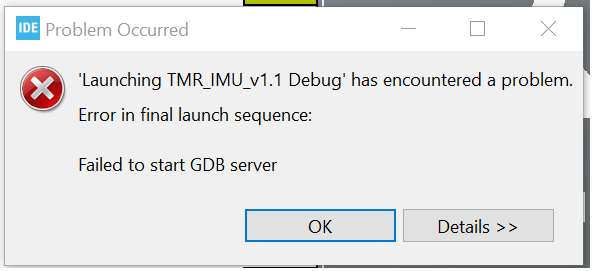

I have chosen the CPU that I have on my custom board (STM32F410R8T6), configured my periphials and written some code. However, I face an issue when trying to debug the program, or run it on the hardware. When I click the debug button, the debug viewer appears shortly, where i can press run and terminate, before it snaps out of it, and shows this error:

Pin are setup as shown above. At no point in the code do i use PA13 or 14, except for the autogenerated stuff, which i presume sets up the SWD interface. I don't make it enter low power mode, and haven't heard of WFI loops. I have it enter multiple interrupt rutines triggered by both spi and external pins though, but i don't think that should matter. I'll try STM32 Cube Programmer at once!

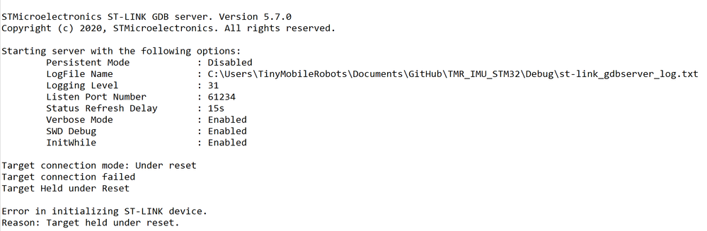

‎2020-11-26 5:42 AM
I tried changing reset behavior to connect under reset. I still see no information (0 V) on the nrst testpoint, but I receive a different error now: And console now reads:
