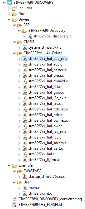

Unfortunately, following the doc. UM2579: Migration guide from SW4STM32 to STM32CubeIDE, the importing process fails.
0693W000005B8f0QAC.pngyou can see some source files cannot be located. I try to change one file's searching path through "properties" -> "Resource" -> "Location" -> "Edit"-> navigate the right location of the source file, the yellow warning icon before the source file disappear. But, there are so many source files with yellow icon. Also, it is not allowed to "edit" the path variable.
The reason may be that the fixed structure of the "STM32Cube MCU software package". Once you copy some parts to another folder, it fails to find the other parts of the package.
However, directly open the SW4STM32 project file, there is no such issue. "Build All" succeed, too.:smiling_face_with_smiling_eyes:

Finally, I found this:
https://wiki.st.com/stm32mcu/wiki/STM32StepByStep:Step1_Tools_installation
5 Launch STM32CubeIDE in debug mode and run my first program
In this section, STM32CubeIDE open the project file created by SW4STM32 directly and using the converter the SW4STM32 project file is converted to a STM32CubeIDE project file. I debug the example application successfully.
