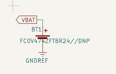

How are you managing the Supercap.
Again, Remember that Supercaps are not like batteries!

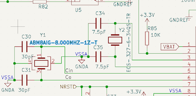

Show LSE schematics part.
Sourabh
Hi everyone,
Here is how my LSE and my supercapacitor is connected to VBAT.
Hi everyone,
So this is your supercap: https://www.yageogroup.com/products/Capacitors/part/FC0V474ZFTBR24
You haven't shown how it gets charged, or how you manage the discharge.
Did I mention that Supercaps are not like batteries?
PS:
SO have you actually checked that Vbat at the STM32 remains within spec throughout the power-cycle ?
Does it work if you just fit a normal, primary battery?
Thanks for your input. Yes, the supercapacitor in my design is the FC0V474ZFTBR24, charged using the STM32L4’s internal VBAT charging circuit (PWR->CR4 |= PWR_CR4_VBE).

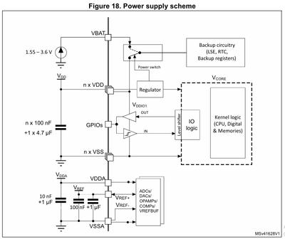

VBAT was measured during multiple power-cycle tests and remains stable around 3.0–3.2 V, which is well within the STM32L431 specification:
“VBAT = 1.55 V to 3.6 V: power supply for RTC, LSE and backup registers when VDD is not present.”
— STM32L431 Datasheet, Section 3.9.6 (VBAT operation)
To confirm the super capacitor wasn't the cause, I also tested with a 3 V LFP cell and also with RPS(3V), and the behaviour was identical — RTC/LSE fails to re-initialize after the second power cycle.

waclawek.jan
If you reset (by cycling its VDD, or otherwise) the mcu while valid voltage at VBAT is present all the time, LSE and RTC remains running. If not, there's some serious problem with the hardware, but you probably can't tell that just by looking at return value of a Cube/HAL function.
Why does HAL_RCC_OscConfig() perform in a different way than you expect I don't know, I don't use Cube/HAL; however, Cube/HAL is open source, so you can debug HAL_RCC_OscConfig() (single-step, observe variables' and relevant registers' content, etc.)  in the same way as you debug the rest of your code.
