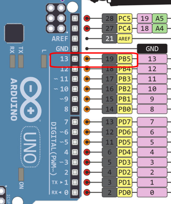

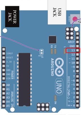

"D13", on the other hand, refers to the pin in the standard Arduino UNO header layout:
This header pin is always called "D13" on any Arduino (or Arduino-compatible) board - irrespective of what microcontroller is used.
On the good ol' original Arduino Uno, the header pin "D13" connects to "PB5" on the ATmega microcontroller:
https://deepbluembedded.com/arduino-uno-pinout/

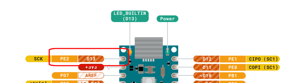

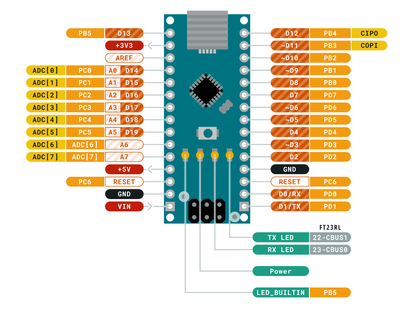

I did some quite complex project using ... Arduino Nano Every (ATMega4809)
So, on that, the "D13" header pin connects to "PE2" on the ATMega4809 microcontroller:
https://docs.arduino.cc/hardware/nano-every/

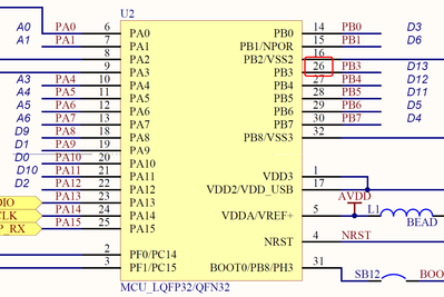

@DSebastian Although not shown in that table, there is also another "pin number" involved:  that's the number of the physical pin on the microcontroller's 32-pin LQFP (or UFQFPN) package - in this case, it's pin 26:
But, again, the executing code knows nothing of this external hardware detail - all it sees the the Port (GPIOB), and the pin number within that port (3).
