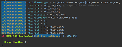

  • Tried fully resetting the RCC using:__HAL_RCC_BACKUPRESET_FORCE();
    __HAL_RCC_BACKUPRESET_RELEASE();
  • This allows the clock to reinitialize, but the stored RTC time/date are lost.

> when we simulate a power loss by manually removing the main power and reconnecting it, the RTC clock fails to configure on the second initialization.
What do you mean by "RTC clock fails to configure"? If there is enough voltage on VBAT pin (i.e. supercap or battery connected to it), you don't need to configure the RTC again - if it retains time, it retains also its configuration.

I don't use Cube so can't help with that. However, Cube is open source, so you can debug it as your own code.
You can check state of the clocks in the respective RCC registers, namely, LSE state is given by the LSERDY bit in RCC_BDCR. You can do this in debugger, too.

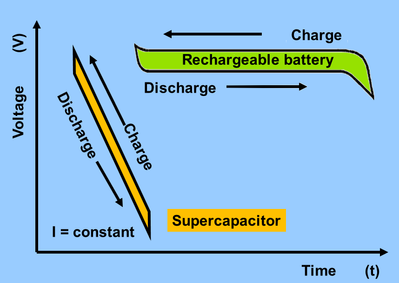

Remember that Supercaps are not like batteries: the voltage decays gradually to zero - unlike batteries, which tend to keep a (relatively) steady voltage until they die:
#SuperCap #SuperCapVsBattery

Here are a few additional details that I missed in my original post. The supercapacitor is connected directly to VBAT. Could this configuration cause any issues?
