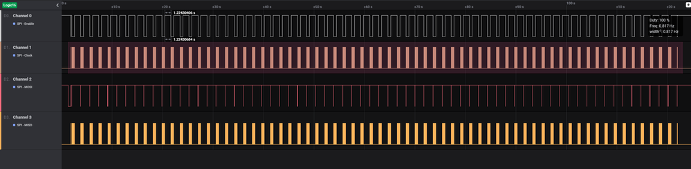

I have made some new test and I have to correct my statement.
It is possible to read out the whole line with one line:
STM32_Programmer_CLI.exe -c port=SWD reset=HWrst freq=24000 -el "PathToSTLDR" -vb 1 -r 0xD0000000 10 "dummy.bin" -r 0xD0000000 33554432 "flash.bin"
There is no limit of size. The Programmer splits into 500kB chunks.
I measured with the Logic Analyzer. Thats the result:
The most time is lost between two 500kB chunks (>1.2s). The transfertime of one 500kB chunk is less than 0.6s. For 32MB it tooks about 2min to transfer.
@Khouloud GARSI​ : Is there a possibility to reduce the time between the 500kB chunks?
Thanks
\Marco
