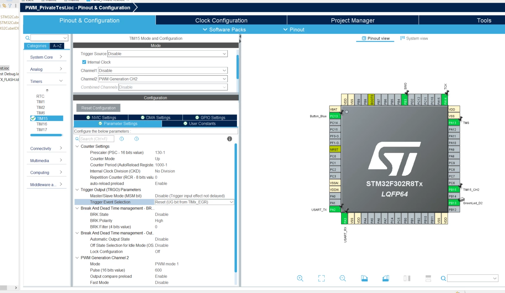

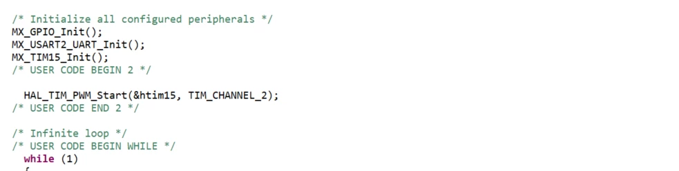

i am working on STM32F302R8Tx and i would like to have a  490 Hz PWM on Timer15 Channel2,
attached are my configuration and my code, when i measure it , i become 491,13..Hz. what can I do to get the exact 490Hz?
Any  Suggestions??
thank you!!!

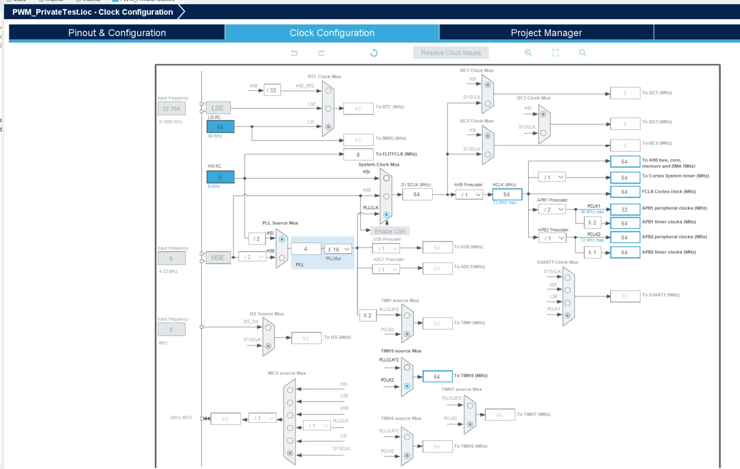

you clock at 64MHz ,
so -> 64M / 130 = 492,3kHz
divide by counter (arr) : (1005-1) -> 489,9Hz (closest you can get here)
If you set 64M / 131  , arr (997-1) , then 490,02 Hz is possible.

Also, HSI is not a precise primary clock source (see datasheet for HSI specification), so there will always be some error introduced by that fact.
