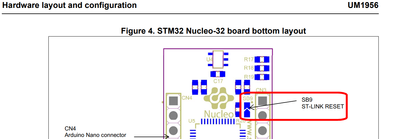

It's here:

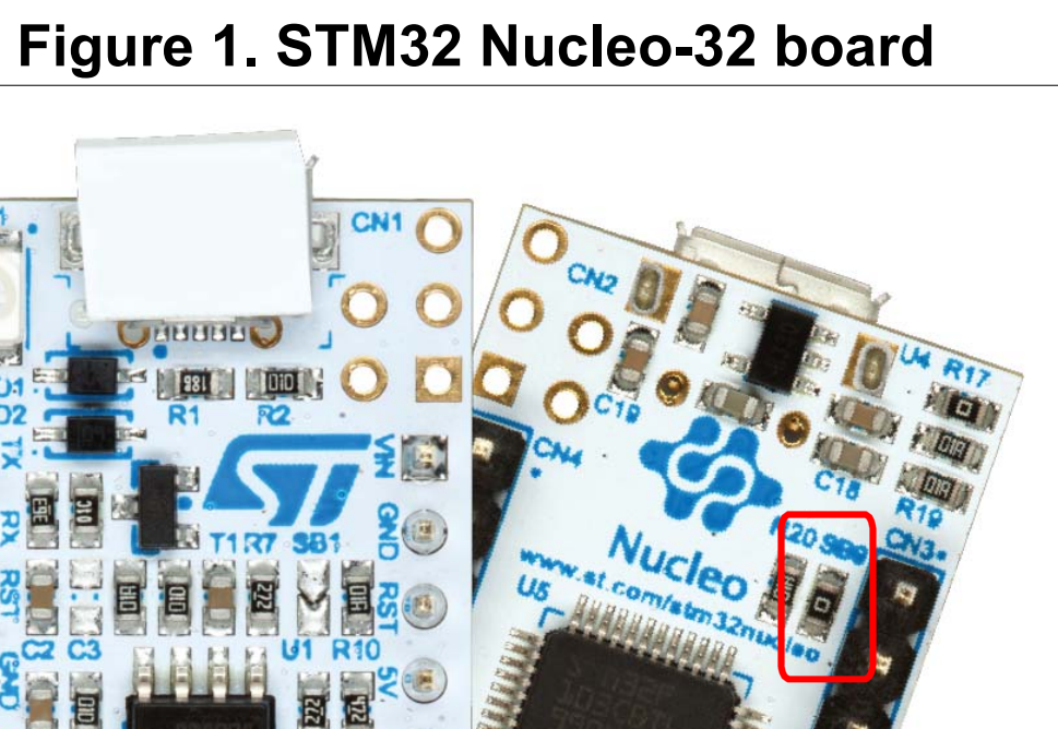

The photo in the UM shows a zero-ohm resistor fitted:
To break the link, you need to remove that zero-ohm link.
There's no need to be particularly careful with it - you don't need to keep it - so just heat it up with a soldering iron until it comes off.

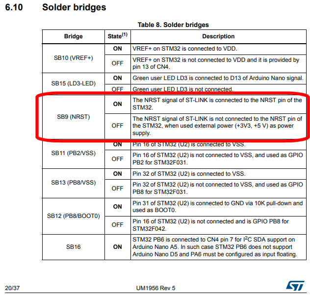

There should be a link you can break to disconnect the NRST signal.
You can also break-off the ST-Link section of the board. <-- Sorry, not on this board - that only applies to Nucleo-64
https://community.st.com/t5/stm32-mcus-products/measuring-ground-current-does-not-seem-to-match-datasheet-on/m-p/716720/highlight/true#M259890
It's SB9:
