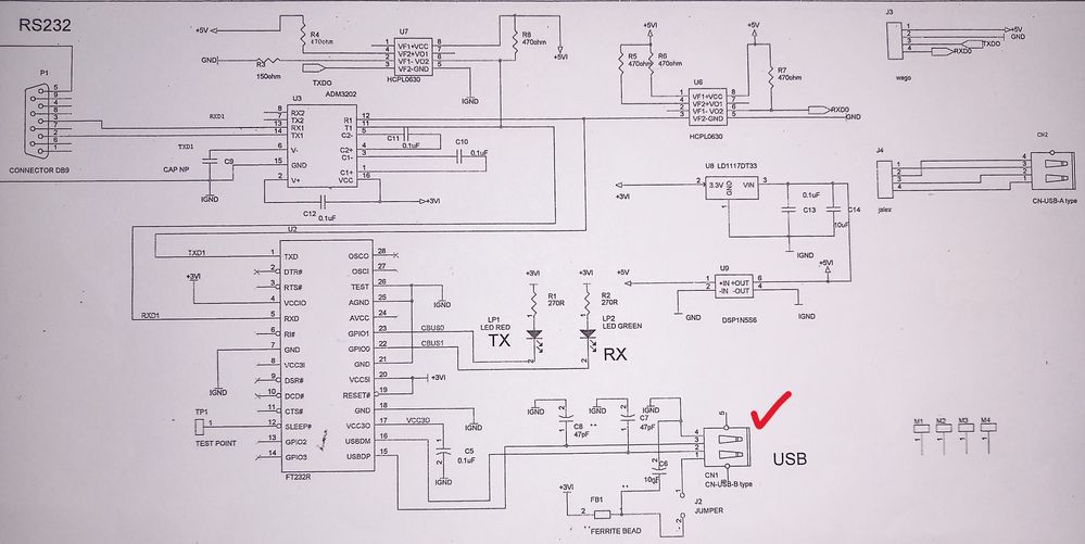

Hi
  • I am trying to communicate between arm processor and nucleo board through uart
  • The processor has a type b usb , to interface with computer.
  • For the same usb I am connecting my Nucelo board through usb type B mini and sending the data through it
  • When i connect the device to laptop/computer the communication happens, and when i connect nucleo the communication does not happen.

Andrew Neil
So this "ARM processor" has a USB Device connection.
The CN1 USB connector on your Nucleo board is also a USB Device connection:
You cannot connect two USB Devices together - a Device can only connect to a Host.
That's because the computer is a Host.

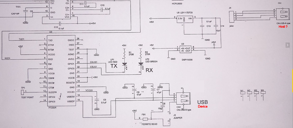

Andrew Neil
What is CN2?
Is that a USB Host port?
  •  YES That USB type A port is used to interface a printer
  • and another port USB type is is used to interface with a computer.

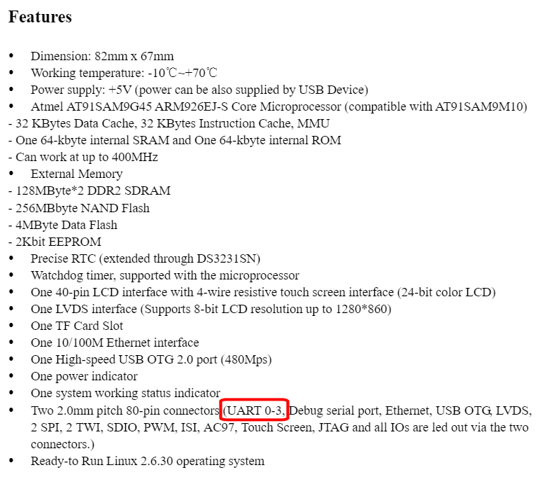

  • And I want to have communication between Nucleo and Processor ( I have attached pdf of processor) .

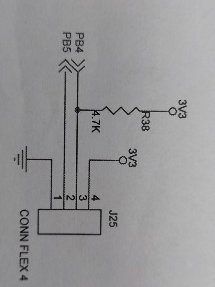

Instead of using this USB connection, could you use a direct logic-level connection to one of the UARTs on your ARM9 board?
Does it support a Hub - then you could use it for both the printer and the ST-Link VCP ... ?
  • It is the  pin PB4 and PB5 of arm processor which is connected to USB device and Interface is happening through PC/laptop. Like sending the data and receving the data.
  • Can I try connecting PB4 and PB5 and GND of arm processor directly to the USART1 pin PA9 and PA10 and GND of my nucleo board through J25(in image)
  • Will the logic level be same between both the boards.
  • Thank you
Which "ARM processor" are you talking about? Both the STM32 and the AT91SAM9G45 are ARM processors!
You need to study the board documentation for that.
AT91SAM9G45 processor.
Andrew Neil
There's not enough information in that brief document - you need a more detailed technical manual.
But this Mini6045 board seems to be obsolete and no longer supported - so no idea where you'll find that.
