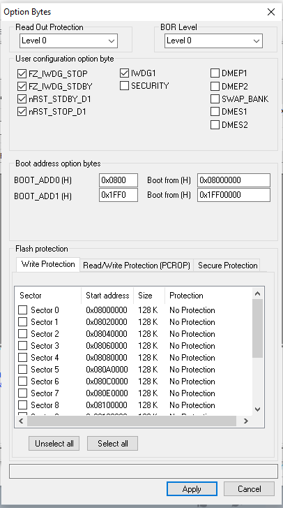

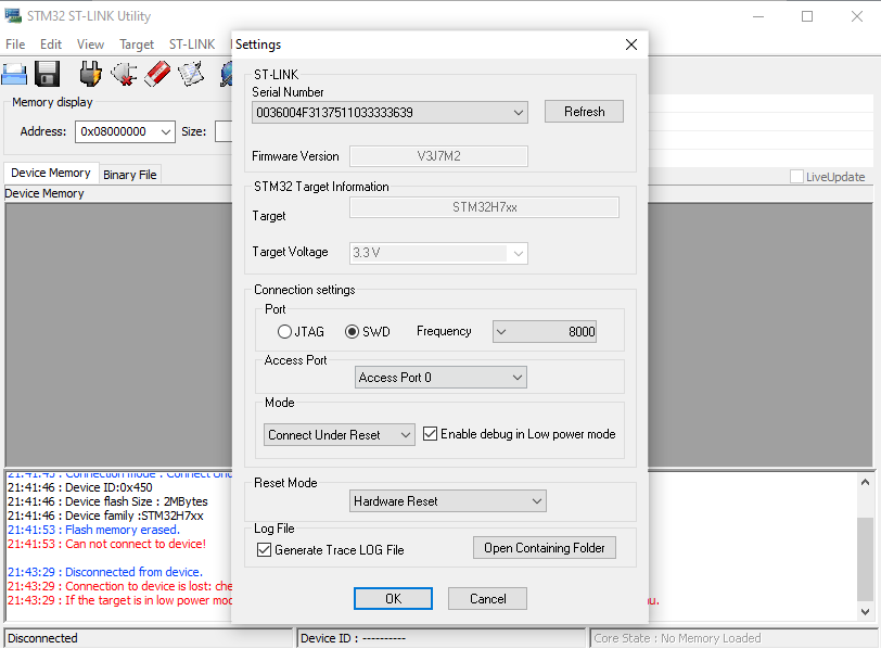

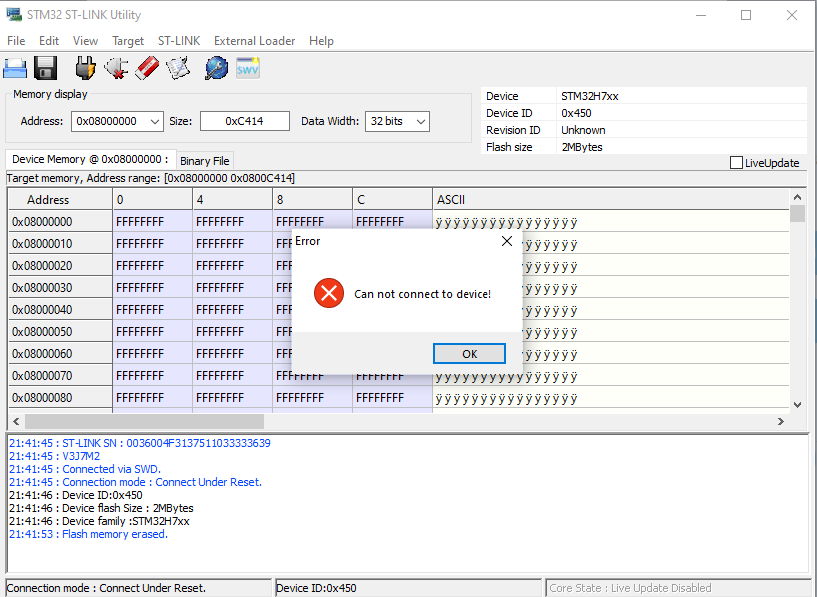

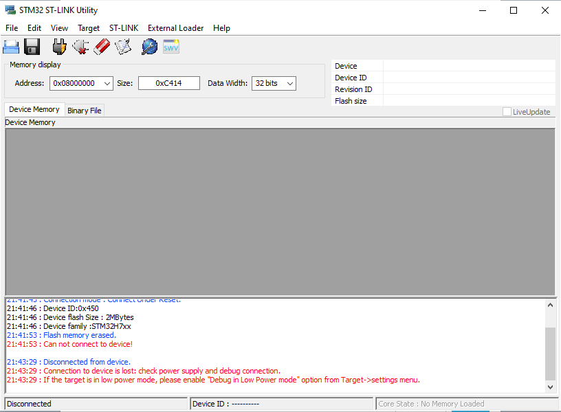

I tried to erase the flash memory using ST-Link to re-flash the code but i encountered something like this,
0693W000008ycyQQAQ.pngThe settings in ST-Link Utility is
