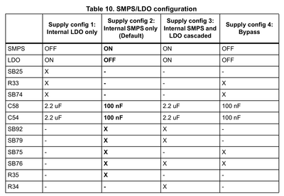

I recently purchased 2 NUCLEO-H755ZI-Q and both of them will not boot. ST has problems. In UM2408 Rev 6 it says the default power configuration is DIRECT SMPS but a quick scan of the board shows SB92, SB75, SB79, SB76 and R35 are INSTALLED. This is in direct contrast to what UM2408 describes in section  7.4.8 as the defaults for DIRECT_SMPS. The board did not come configured for DIRECT_SMPS.
After observing this I tried configuring my software for PWR_LDO and it still will not boot.
after each attempt I must hold BOOT0 high with a wire during power up then erase the FLASH using ST Programmer. The MCU always comes back after this process but something is royally screwed with the board's power configuration coming new from ST.
ST needs to investigate this and get it straightened out.
PWR_DIRECT_SMPS_SUPPLY is the correct default option.
I can create a default CubeMX project for this board, which has PWR_DIRECT_SMPS_SUPPLY selected, and can program/debug normally.
I'm not seeing a contradiction here. "X" means installed. "-" means not installed.
"Internal SMPS only" and "Direct SMPS" are the same. The core is powered directly from the SMPS.
As stated by @TDK, the default configuration of that board is SMPS. No need for any modification.

I have come to that conclusion. X means installed. It took quite a few iterations of attempt to program, no device detected. BOOT0 high, erase FLASH and reprogram ...   then it suddenly started working. Why I had to go through that is a complete unknown but I did go through this to a lesser degree with an H747-DISCO also.
