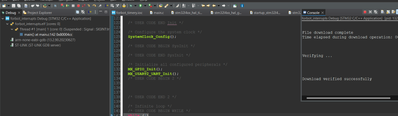

Unfortunately, as it is shown in the picture up, the debugger is not entering the interrupt code part and I don't know why
All that picture shows is that you weren't in the interrupt at the time you took the screenshot.

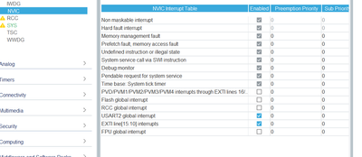

I have enabled the interrupt

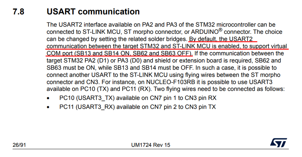

Board: NUCLEO-L476RG
So are you using the on-board ST-Link's VCP (Virtual COM Port) for sending & receiving?
This does use USART2 by default - so be sure that you (or any previous users of this board) haven't changed any links. Also that no "shield" is connected which uses these pins:
I don't really know how to check these.
Then you really do need to spend some time on basics before moving on to interrupts!
Simply transmit in a loop using HAL_UART_Transmit():  this function is blocking - ie, it does not return until the transmission is complete.
Once you've got that working, then try reception in a simple loop using HAL_UART_Receive():  again, this function is blocking - ie, it does not return until the reception is complete.
CubeIDE has examples for doing this on your Nucleo board.
