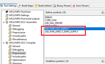

As #if #elseif are used, that sets the board to LDO power mode which is not the right power config of the board. The correct config is SMPS (the 3rd condition: #elif defined(USE_PWR_DIRECT_SMPS_SUPPLY) && defined(SMPS))
Unfortunately if you remove the definition of the define USE_PWR_LDO_SUPPLY from the project preprocessor and you regenerate the code it will appear again. So for the moment each time you generate the code you need to remove that definition and keeping USE_PWR_DIRECT_SMPS_SUPPLY.

Now as your board was wrongly set to LDO instead of SMPS you need to recover it.
1- Disconnect the STLINK USB cable
2- Connect BOOT pin to VDD
3- Connect the STLINK USB cable
4- Use Cube Programmer and erase the board.

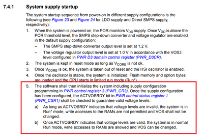

Note that the implementation of that new function was to be inline with the specification described in the reference manual regarding RUN* mode:

Thank you very much for the good explanation and the solution. I went into Project->Properties->C/C++ Build->Settings and deleted the definition of USE_PWR_LDO_SUPPLY as you explained and everything works again. I will remember to delete the definition every time the code is regenerated.
Best regards Nikolaj
