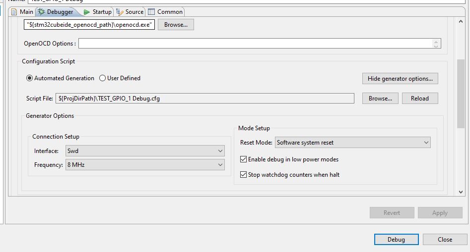

I am using STM32CubeIDE for my project . when i want to run the code i am getting this pop up.i am not able to solve this issue.
Best answer by LaurentL
OK, you didn't connect the Reset pin.
If you can add the connection, it's better.
Then, without reset coming from STLink, you should avoid "Connect under reset" mode in debugger tab in debug config.
Like you did on STM32CubeProgrammer, use "Software Reset system".
Try to mass erase the device with STM32CubeProgrammer before debug.

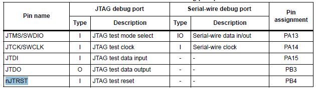

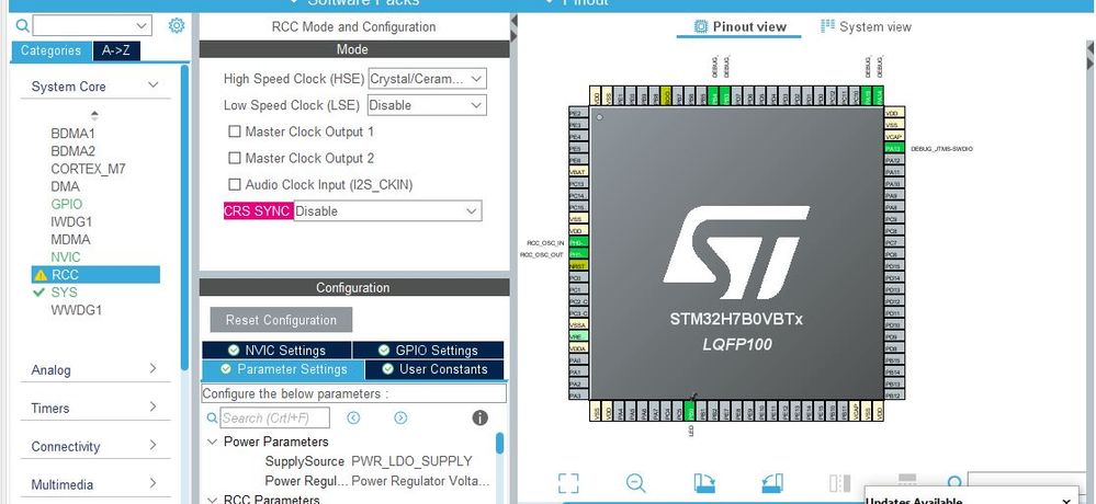

After selecting JTAG, it show some warning and i see red mark in rcc. if i put cursor it shows "crs sync conflict with DEBUG: Debug JTAG(5 pins)".
when i select low speed clock it becomes yellow. Please help me.
LaurentL
May 26, 2021
OK, I think you need to double check the pins used for JTAG that can conflict on RCC stuff.
Why do you want to use JTAG if SWD is working fine ?
SWD uses less pins (no need of JTRST or JTDO) and you can do SWV with SWO pin (JTDO).

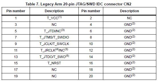

Looking again your schematic, it seems you are connecting Reset pin of STLink Pin 15 of 20 pin connector on your board to JTRST.
It should be connected to NRST of Mcu, not JTRST.
I think you should check STLink user manual on pins used.
On the 20 pin connector table, it is T_NRST for pin 15.
