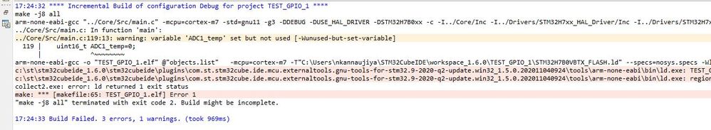

my Microcontroller has 1.4 Mb of RAM. I need 700 Kb. when i am exceeding 128 Kb it is showing error (RAM overflowed by 1904 bytes).
I have attached screenshot and one .txt file that has error message. please resolve this problem.0693W00000BaI3EQAV.jpg0693W00000BaI34QAF.jpg
This is already a monstrously long thread, honestly got a NEW problem, start a NEW thread.
The 1.4MB is likely NOT contiguous, you're going to need to define the different spaces in the Linker Script (.LD) or related UI, and then direct content into the various RAM regions depending on appropriateness, either at an object/routine level or via the attribute directive.
