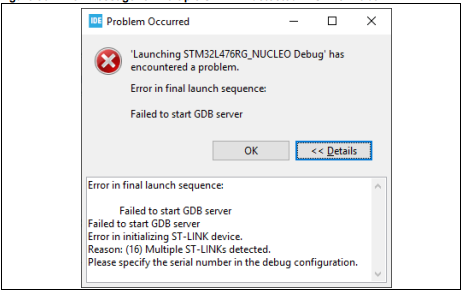

If you try to launch a debug session with two ST-LINK connected, a pop-up message appear as shown in the figure below:
_legacyfs_online_stmicro_images_0693W00000bi5aFQAQ.pngPlease refer to AN4989 and precisely Appendix C Managing various targets on the same PC/ STM32Cube IDE section.
I hope this help you to solve the issue!
