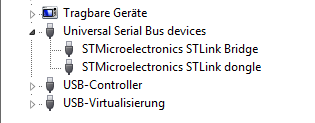

on Win hear USB connection, ding-****, see in STMCubeProgrammer -> refresh :
_legacyfs_online_stmicro_images_0693W00000bkI2PQAU.pngand in hardware manager on windows ->
_legacyfs_online_stmicro_images_0693W00000bkI13QAE.pngand on stlink-V3 red LED on - otherwise take another cable and USB port...

Sorry, WIndows 10. And no, no sound, nothing on device manager, no LED. I guess I god a dud. Ok, no big deal, those are practically free.

on win10 (other PC from co-worker ) "nothing" happens , no error, no sound.
but no LED -> no power at all ! -> take another cable and other USB port... and check !
