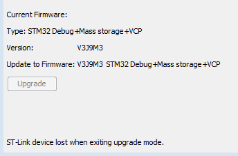

ok, try on Win7 PC now update + change type :
_legacyfs_online_stmicro_images_0693W00000bkdj1QAA.png..device lost. new exciting gameplay...
then:
after upgrade try plug out and in to get new enumeration, but:

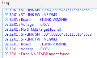

_legacyfs_online_stmicro_images_0693W00000bkdoFQAQ.pngthen, after some minutes (!!) - working.
_legacyfs_online_stmicro_images_0693W00000bkdooQAA.pngso:
  • download and install new win. drivers
  • update firmware + change type
  • wait some minutes...

Have you connected the Vcc pin of MINIE to the target?
shure...
if you think about the 0,00V message : there was no target, just connect to St-Link was proofing connection.
problem was : need install driver (!) never need this before. new driver from STM needed.
and then update firmware / change type !
