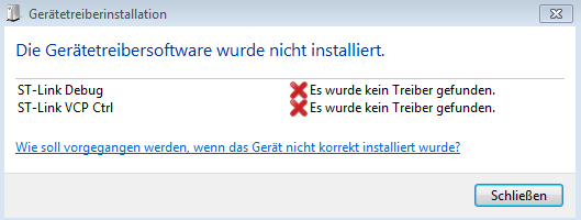

new (from mouser) STLINK V3 MINIE not working on Windows PC (win7) , no driver found !

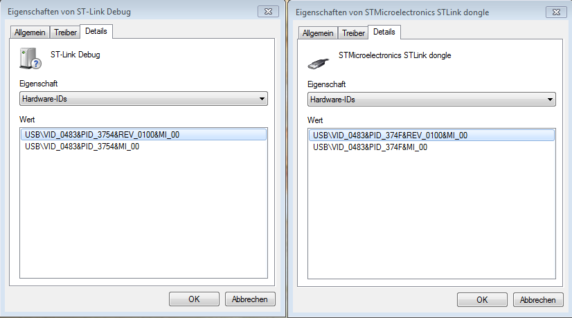

hey, on same PC STLINK V3MODS working without problem !
the brand new V3MINIE also on Win10 doing nothing - no error, no enumeration.
on win7 here :
no driver found.
_legacyfs_online_stmicro_images_0693W00000bkHFwQAM.pngand compare on USB V3mods right and V3minie left side:
_legacyfs_online_stmicro_images_0693W00000bkHGBQA2.pngdifferent PID .
what can i do now ?

Try to manually (in Device Manager) install the WinUSB driver on it.
(Update driver-> Browse-> Let me pick from a list of available drivers on my computer...)
Unfortunately Windows 7 is thing of the past (support ended) so - products are no longer tested against it.
For the VCP interface, Win7 does not have in-box driver for USB to serial adapters at all. Install the ST provided driver.

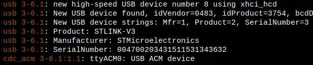

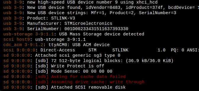

i downloaded driver pack /zip , manual install drivers (why ? same is running in Vmods version - i cannot understand this game, STM is playing )
now both V3 versions working, just the V3minie showing no msc drive, only debug and vcp . on win 7 PC .
+ now test :
both connect and work instantly on linux ( MX 18 ) , 5 y old now , but updated ;
in linux it shows:
_legacyfs_online_stmicro_images_0693W00000bkIpHQAU.pngbut V3mods shows a drive :
_legacyfs_online_stmicro_images_0693W00000bkIqAQAU.pngso V3mine has NO msc drive to flash something!

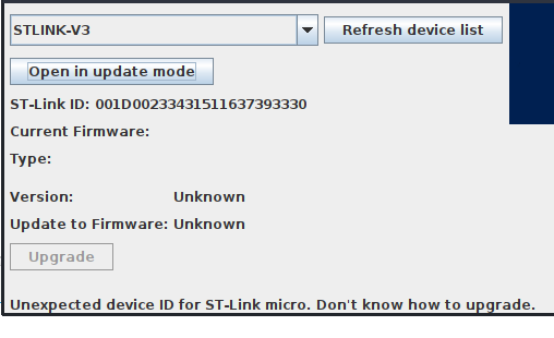

Bob, i tried now... (on Linux) and see:
_legacyfs_online_stmicro_images_0693W00000bkJDdQAM.pngok , so it want update programmer first and then - maybe- new game . or not .
i didnt want to begin a game, i just buy this new and genuine STM programmer, because
my old ST-Link V2 are "fakes" or whatever now Peter Bench or STM call them now, i didnt know about this before. and i recommend this s-hi-t to my company, so i have a problem now. Better, i never recommended STM products - maybe.

I am a bit concerned by the "Unexpected device ID for STLink micro" message at the bottom of the dialog box.
What version of CubeProgrammer are you using? The latest is 2.13.
Click on the "open in pdate mode" and see what it shows you for current version and whether MSC is enabled. Include a screen shot of that dialog if you have any issues. You might also include a picture of the STLinkV3, just in case (top, bottom and close up of the CPU).

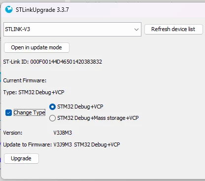

@AScha.3​ The device ID of mini-e is indeed VID_0483&PID_3754&MI_00
So this is correct, and your STLink Upgrade utility is too old.
Do the update on a machine with latest CubeIDE or CubeProgrammer - even if this is a Windows machine.
Click on Open in update mode then Change Type.
_legacyfs_online_stmicro_images_0693W00000bkOZ5QAM.pngNote, while in the update mode, the ST-LINK disconnects and turns into a different USB device with PID =374D and single interface (DFU?)

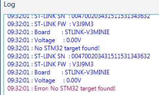

ok, try on Win7 PC now update + change type :
_legacyfs_online_stmicro_images_0693W00000bkdj1QAA.png..device lost. new exciting gameplay...
then:
after upgrade try plug out and in to get new enumeration, but:
_legacyfs_online_stmicro_images_0693W00000bkdoFQAQ.pngthen, after some minutes (!!) - working.
_legacyfs_online_stmicro_images_0693W00000bkdooQAA.pngso:
  • download and install new win. drivers
  • update firmware + change type
  • wait some minutes...
thanks to all who have helped clarify ...

Have you connected the Vcc pin of MINIE to the target?
AScha.3
AScha.3Author
May 27, 2023
shure...
if you think about the 0,00V message : there was no target, just connect to St-Link was proofing connection.
problem was : need install driver (!) never need this before. new driver from STM needed.
and then update firmware / change type !
crazy...because the almost identical V3mods working instantly !
would you expect the almost same product from same company behave totally different ?
