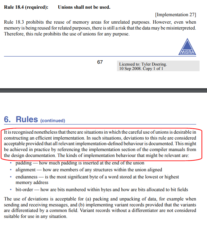

So I read the rule 18.4 of MISRA C 2004 compliance, and surprisingly, I didnt fount any
information and how a union in a struct should be write in code.

Have you actually read the MISRA document?
So the notes you've seen in the CMSIS Library comments are just fulfilling that requirement to document this deviation from the Rule.
This is acceptable.

But that doesnt really answer my question : is stm32cubeIDE use C MISRA 2004 Compliance ?
I dont know why I get a warning from the struct I provided (from the source-code).
Yes, it does answer the question about MISRA compliance - it meets the compliance criteria of documenting what it does.
