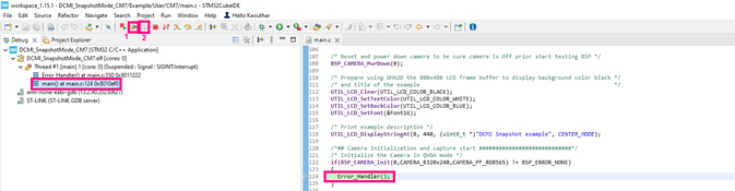

2024-08-02 5:33 AM - edited 2024-08-02 6:53 AM
Hello @syrine and welcome to the community :),
For the warning issue could you please try with the last version of STM32CubeIDE.
If you click on resume then suspend as shown in the below figure, do you get an Error_Handler()?
Thank you.

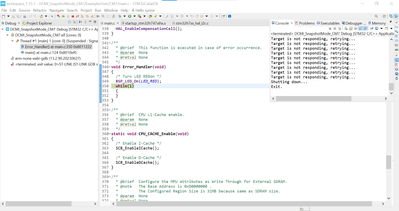

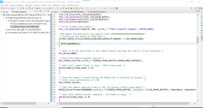

2024-08-05 2:47 AM
Good morning ,
yes , there is this error :

Hi @syrine ,
I think you face the same issue as reported here.
This issue can happen if the camera is not detected. It might be due either to a wrong connection or a malfunction of the camera board.
I advise you to plug and unplug the camera board while the board is not powered. A short-circuit can happen otherwise.
Could you please try with another B-CAMS-OMV camera board?
Thank you.
