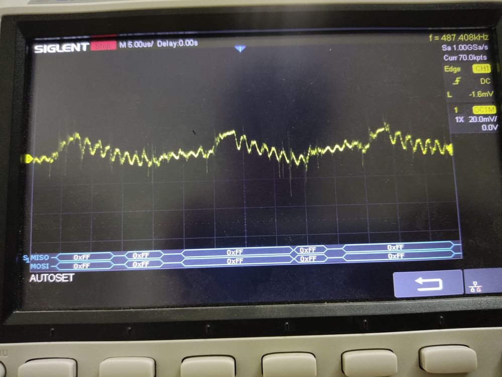

I connected one probe to the SPI MOSI pin and sent the data 0xE to the TFT, but it showed 0xFF.

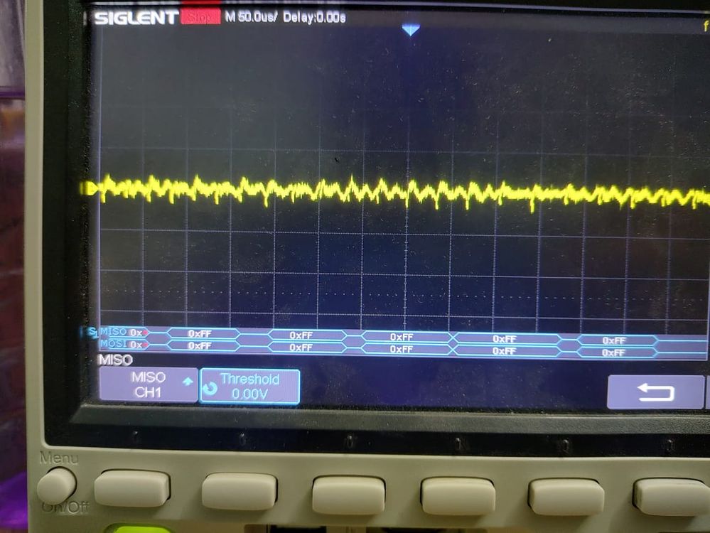

hi @AScha.3  sorry for my late reply. I tried, but the signal shows a value of 0xFFWhatsApp Image 2024-07-22 at 10.43.59 AM.jpeg
I see no useful signal...
Ask (your teacher ? ) how to use a scope.
1. set probes to  10:1
2. control/adjust probes with ref.signal
3. connect mosi + clk , show the traces
4. maybe set scope to decode mosi+clk

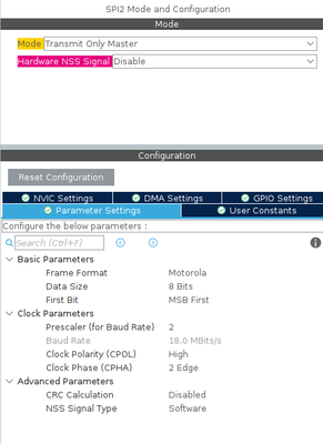

@AScha.3  Our company is small, and I am a fresher, so no one is available to help me. Please give me some guidelines. How do I calculate the prescaler value for SPI in the ILI9488? The HCLK is 250 MHz. Based on the dot clock frequency (DOTCLK = 20 MHz), I set the prescaler
Ok,
so see in Cube/IDE what you set:

@AScha.3  I checked that the SPI is working well on the oscilloscope and i saw the signal also, but the TFT is still not working. i want small changes in my TFT like showing bg color.if i get anything,easily i will take into another level.
Thats "standard" !  (None of my TFTs working at first - always something was wrong. )
IF hardware/wires ok ...
IF SPI setting/timing ok...
IF TFT start/init settings ok...
THEN you see first (!) time something , anything happens on the screen. random pixels...
THEN your close, write cls/filled rect , etc. - it will work.
Now you still at the "IF" stage. :)
