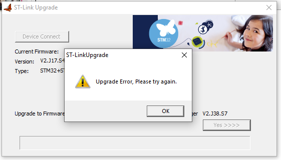

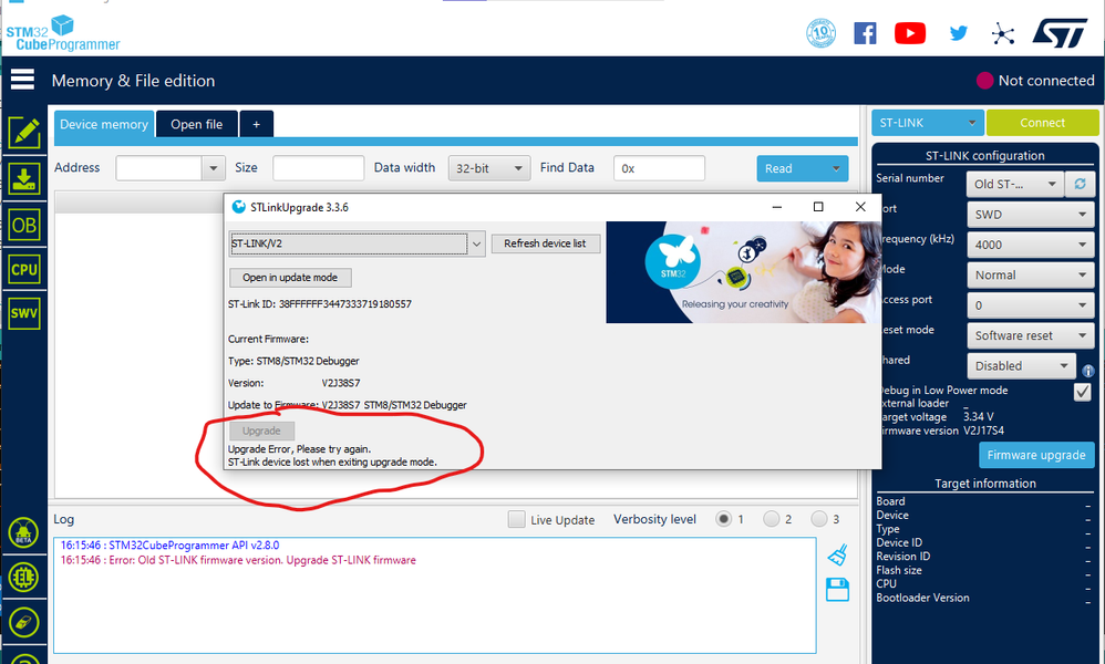

I could not upgrade ST-Link firmware. I always get an error using the Cube Programmer
AHass.3
0693W00000Dq3zNQAR.pngfirstly I got an error on the Arduino IDE:
Error: Old ST-LINK firmware version. Upgrade ST-LINK firmware
Error: Old ST-LINK firmware! Please upgrade it.
then I followed the instructions on how to upgrade, this is what comes up in the STM32CubeProgrammer:
can someone please help?

What type of programmer do you have? Show a link to it.
Try running the standalone upgrade tool from outside of Cube STM32 Programmer.
Make sure it's not connected to any other IDE
i am using the stm32 cube programmer.
i downloaded it from this link:
https://www.st.com/en/development-tools/stm32cubeprog.html
The hardware, not the software.
thanks for your response
i tried the standalone upgrade tool as well, here is what i get;
I suspect, but have no inside knowledge, that ST has changed something in the upgrade process which rejects knockoff programmers like this one and/or the very likely counterfeit chip on there is not fully compatible. There are occasional reports like this.
I see. To be honest, I wasn't aware it is a knockoff programmer. Anyways, thank you for the information TDK :)
