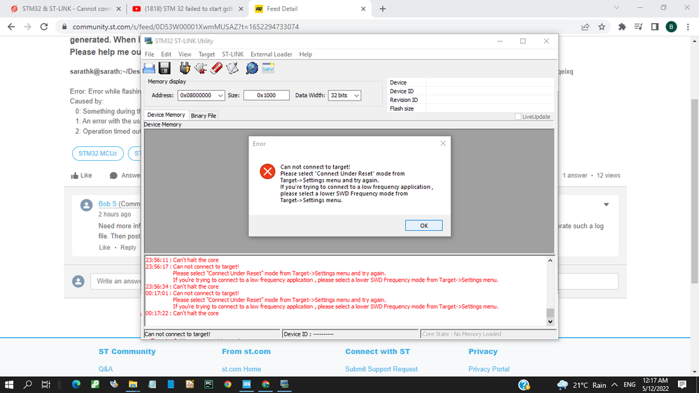

The ST-LINK Utilities have been deprecated for several years, use the STM32 Cube Programmer tool, it should be new enough to support L5 parts
Hi @bsara.1​ ,
Try to do an ST-Link update (Help -> ST-LINK Upgrade) then check if it resolves the issue.
-Amel

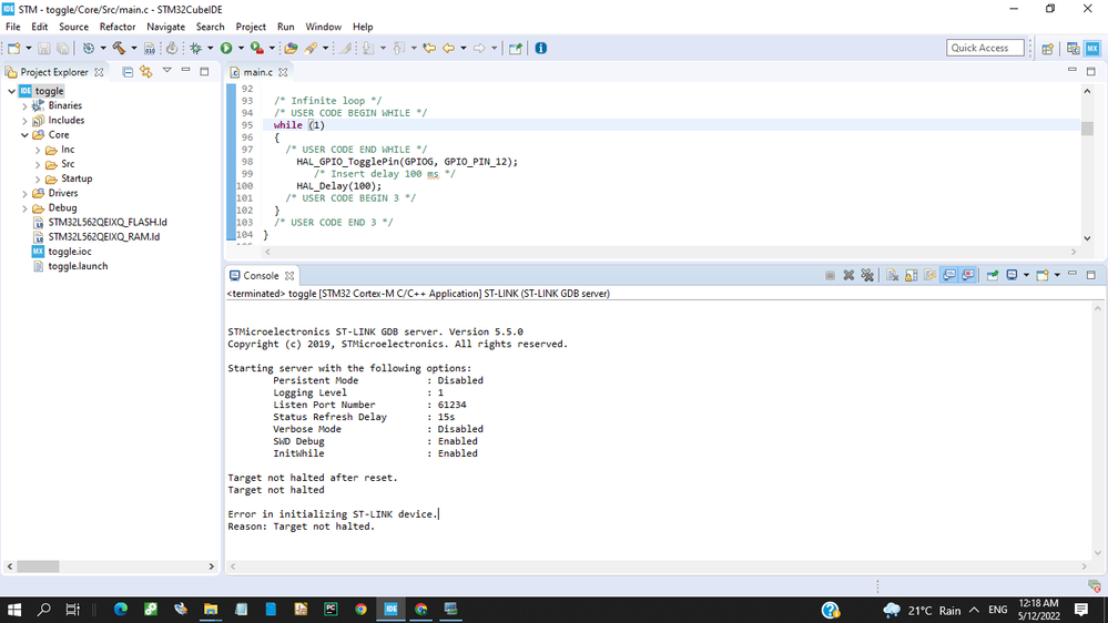

Thank you, I also tried with with stm32 Cube programmer tool. The same error I am getting. Is it a hard ware issue?

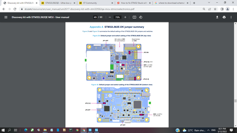

0693W00000NprHTQAZ.pngThank you, the picture shows the default connects on my board. I have tried by upgrading the ST-LINK firmware update. I got same Error. Is it a hardware issue?
Possibly
Use High Quality USB Cables
Try different cables, different ports, different computers, see if the issue follows.
Avoid Hubs

Did you try enabling "connect under reset" as suggested in the 2nd image you posted?
Is this the first time you've tried programming this board? Or were you able to load a program before and now it fails?
Did the board run with the pre-installed demo firmware? (I'm not familiar with this exact board, but they usually come with some kind of demo installed on them).
