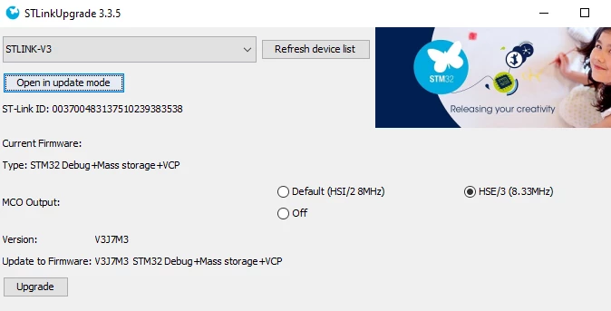

That is the ST-link V3 on NUCLEO-H755ZI board.
The HSE MCO option is set to HSE/3, how to change it to HSE/5.
Usually this is configurable in code, but this is ST-link firmware. If there is a way to change the division value, please some one let me know.

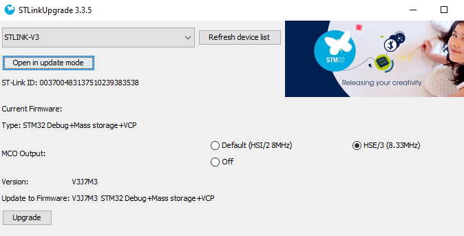

O.Elsherif
April 19, 2021
Here it is.
0693W00000900ayQAA.pngI would like to get some thing accurate that could be multiplied to get 480MHz.
The PLL allows maximum multiplication of 512, which should produce (in my case) 960MHz, after that there is a /2 divider.
A PLL pre-division also exist.

Vangelis Fortounas
April 20, 2021

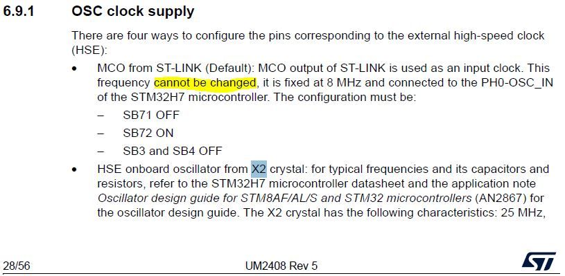

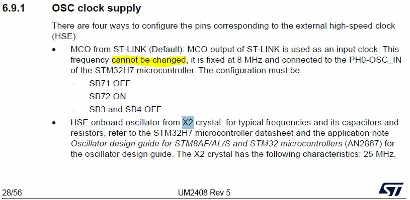

Hello
I ignored this picture with STlink Upgrade MCO freq. Also user manual needs an update.
I think is not possible to take 480 from 8.333 with the existing limitations of PLL1. If DIVM1 is 5, 420 and less is ok if DIVM1 is 3 => 475 , 450, ... etc is ok.
If onboard X2 crystal is present , consider use it .

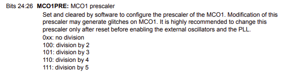

The STLINK-V3 chip is STM32F723IE, and by referring to the (MB1363-H755ZIQ-D01_Schematic) sheet 9 (also page 9) which contains (STLINK_V3E), it shows:
By further referring to the datasheet (page 76), it shows:
Now, by looking at page 144 in the Reference Manual we see the prescaler setting in the RCC->CFGR register:
I need to change this setting (from 3) to (2, 5, or 0 if possible for 25MHz), we should find a way to do this, maybe ST should allow this in the future firmware update, but also if someone knows a way to do this please tell me.
O.Elsherif
April 23, 2021

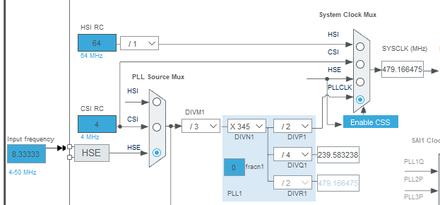

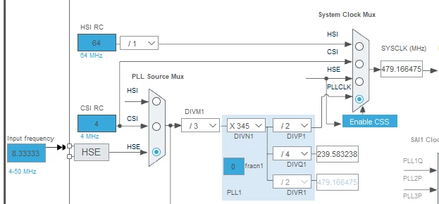

Actually, I figured out that using the fractional part of the PLL could achieve a good result.
Using the following configuration:
DIVM1: 3
DIVN1: 345
FRACN1: 4915
DIVP1: 2
The equation is: input_frequency / DIVM1 * (DIVN1 + FRACN1 / 2^13) / DIVP1
This would lead to about: 479.99996609
With a difference about: 0.0000339 Hz (%0.0000000706)
I think this would be acceptable.

S C
S CBest answer
September 18, 2023
Sorry for having missed this topic. The ability to change the MCO source on STLINK-V3E boards has been added in response to another topic: ST-LINK provides 8.08 MHz instead of 8.000 on new ... - Page 3 - STMicroelectronics Community. It has been documented in RN0093 rev23 (11 may 20) and remains in the history of more recent versions. The impact on all other boards UM has been missed, concerning the UM2408 it's all the more a pity as it has been updated afterwards for other things (23 march 21) ...
Technically at that time the aim of the change was to increase the accuracy of the clock, and it has been decided (mainly for graphical interface simplification reason), to provide only a single value based on the HSE, close to the initial 8MHz, and hoping that an additional factor of 24/25 in the PLL could address most cases. We also decided to change the oscillator of the STLINK-V3EC boards back to 24MHz to fix the issue on future boards.
For this case especially, I think we will add the HSE/5 selection in STLink-Upgrade applications. I'm wondering also about the HSE/4 which could also allow other "high" frequency multiples.

ASche.5
August 1, 2024
I am confused how can this be done and changed in the V3 on Nucelo board that do not have a 8MHz base is there only the firmware update tool ? What else I just started with STM32H7 that has 25MHz base clock and I measure regardless of the settings in the firmwar tool som 17.somthing MHz at SB72 this is a MESS. Please can some one explain what is going on??!?
S C
August 5, 2024
Initially boards have been produced with a single MCO output value: 8MHz, generated from the internal HSI of the STM32F723. Afterwards, several versions of ST-Link firmware have been published to extend this behavior; the last modification is available since V3J14M5 and allows several derivative values from the ST-Link 25MHz HSE additionally to the 8MHz HSI (selection is possible during the ST-Link firmware update). Concerning your point regarding SB72, please precise the board references and please also double check with the most recent ST-Link firmware version (STSW-LINK007 - ST-LINK, ST-LINK/V2, ST-LINK/V2-1, STLINK-V3 boards firmware upgrade - STMicroelectronics). If you changed something regarding SB configuration since board out of the box, please double check that the MCO from ST-Link is not conflicting with another feature. You might also check against a possible conflict with the running application
ASche.5
August 6, 2024
Thanks for the hints and summery of the HSE options on the nucleo board. The problem that I faced was that I measured something obscure like 6-7MHz on the SB72 jumper. But after updating the ST-Link again I had 8MHz clock but a jitterd  one, this was one the  HSI of the F733. Now on the HSE the 8.33 are stable enogh but force me to have fracrtions in the PLL of the STM32H7. I guess its fine for the moment and I will upgrade my nucleo to have a HSE crystal in future.
