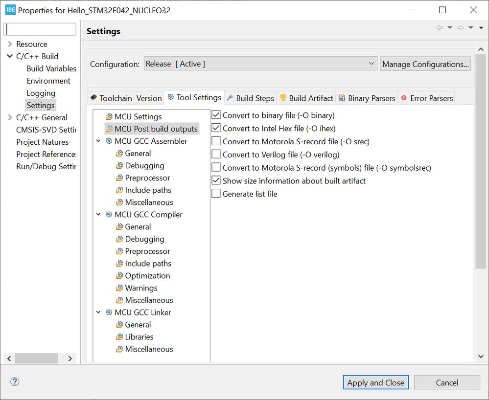

My project compiles with no errors and no warnings. Debug configuration generates a .bin, but Release configuration will only generate a .elf, that STLink will not use under Windows. I have tried selecting C/C++ Build ->Settings ->Tool Settings ->MCU Post Build Outputs for .bin etc., but this doesn't work.

I think you used the right setting for Debug configuration, but curious if you did the same for Release configuration?

I can see no difference between the settings for Debug and Release configurations, but I am new to all of this and I may not know what to look for. Please let me know what settings I need to create a Release configuration that STLink will accept. I am using Internal Build instead of external make.

Enabling the binary/hex check boxes in Project > Settings works fine for me:

I had set the binary/hex checkboxes for my Release configuration and I have updated STM32CubeIDE Version 1.0.2, , but I am still not generating .hex or .bin executables. Also, looking at the internally-generated makefile, there appears to be no command to build .hex or .bin; only .elf.....?
