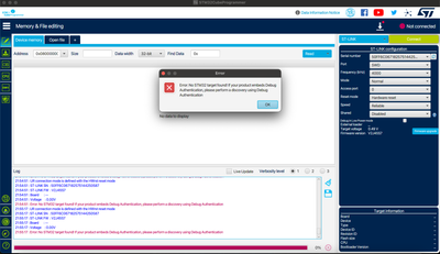

I encountered this error when I was trying to flash my custom board with fresh stm32F070C6T6. I used st link v2 for debugging. I updated the firmware of st link v2 right before debugging.
NRST floating, BOOT0 connected to 3V3 -> failed (in any mode)
NRST floating, BOOT0 connected to GND -> failed (in any mode)
NRST connected to GND, BOOT0 connected to 3V3 -> failed (in any mode)
NRST connected to GND, BOOT0 connected to GND -> failed (in any mode)
I also tried both on Windows and Mac(m3), and was not successful.
I also tried Cube IDE, Cube Programmer, and st link utility, but all did not work.
I also tried to use DFU, but it also failed. (no dfu detected)
I measured the voltage to be 3.16V and ensured the wiring was ok.
Now, I have no idea what I should do to fix this issue. Can anyone point out where it went wrong?
Thanks.

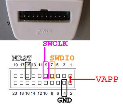

There must be something wrong with your wiring - your ST-Link is seeing 0V !
Are you sure you have the pin numbering correct?

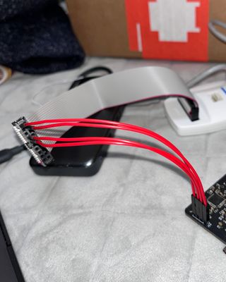

The view is looking at the pins in the ST-Link:
Here is my wiring. The pin header is shown at the corner of the black PCB, and connected to the st link v2.
Then I tried to connect, but it did not work.
The 3V3 on your board needs to connect to VAPP:
One of the header pins is 3V3 and is connected to VAPP.
In the previous photo, the first pin from the left is the 3V3 pin.
Could you try to connect with the other modes (Normal, Hotplug, etc...) :
Please make sure to pull-up the NRST signal to 3.3V.
Maybe I'm wrong, but I don't see it connected to anywhere.
Are you sure you have the ST-Link pins correct?
ie, are you sure it's pin 1 - not pin 19 ... ?
I have tested all of the modes and did not work.
Plus, I think NRST can be left floating since it is pulled up internally, so I am not connecting it anywhere.
Ah yes ! the red line on the ribbon cable is pin 1...
Yes you're right, I have just checked the datasheet:
I am not 100% sure since I am new to this, but I could not find anything wrong here. I also thought that I should use pin19 instead of pin1, but when I swapped pin1 with pin19, my power LED did not light up.
