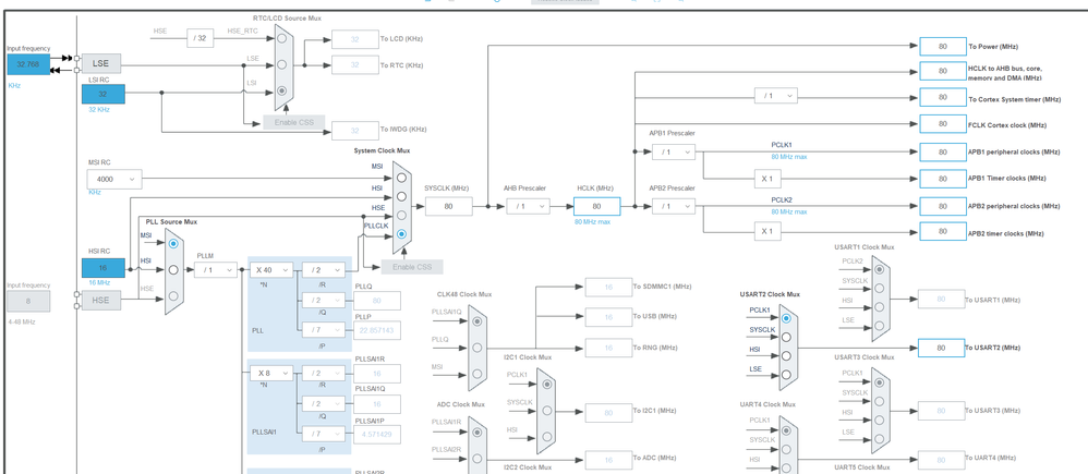

ST-Link VCOM works at least to 921600 b/s (surprise). Nucleo-L476 (and a bunch of few other Nucleos, mostly with STM32L MCUs) have a quirk - there is no 8 MHz clock feed from ST-Link to the MCU. To get the correct and stable baud rate you need to use PLL fed by MSI (NOT HSI16, which sems to be the current default in CubeMX), and enable the LSE oscilator. Then the CubeMX will automagically synchronize MSI to LSE. If you don't do that, remember that HAL removes the factory callibration of internal oscillators, so your clock frequency may not be too close to the nominal one.

I guess that to use PLL fed by MSI is to use the settings shown in the figure. But still failed, did i do something wrong?
