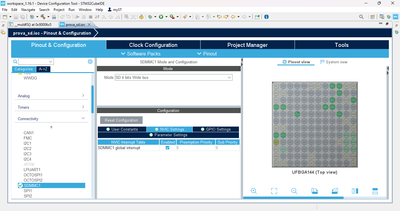

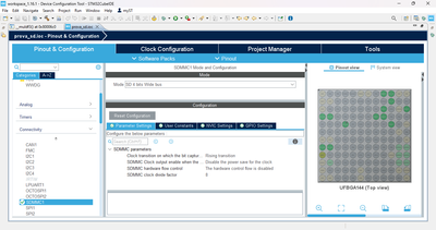

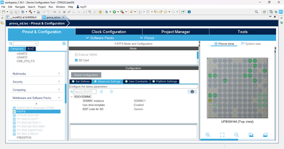

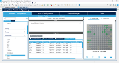

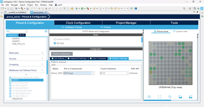

I'm trying to manage the writing and reading of files on the SD card of the STEVAL-STWINKT1B board, but when I run an f_open it gives me FR_NOT_READY, I've tried with different SD cards but the result doesn't change, I ask if anyone has any suggestions on what it could be,
I'm working with stmcubeIDE v 1.16.1 and stmcubeMX v 6.12.1
the configuration on cubeMX is the following:
Luca4_0-1730546238620.pngLuca4_1-1730546257603.pngLuca4_2-1730546280063.pngLuca4_3-1730546297071.pngLuca4_4-1730546309719.png

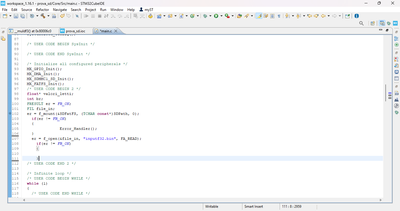

On stmcubeIDE in main project I only entered the function f_mount and f_open:
with the debugger I saw that f_open returns me FR_NOT_READY.

Card Detect Pin:
If you're using a card detect feature, ensure that the pin is configured correctly in your code. It should be set as an input with a pull-up or pull-down resistor as necessary. If the card detect pin is not configured or wired correctly, it may lead to FR_NOT_READY errors35.

I debug the project and saw that the issue is in stm32l4xx_hal_sd.c function:
 /* Identify card operating voltage */
  errorstate = SD_PowerON(hsd);
  if(errorstate != HAL_SD_ERROR_NONE)
    hsd->State = HAL_SD_STATE_READY;
    hsd->ErrorCode |= errorstate;
    return HAL_ERROR;
 this is a function inside BSP_SD_Init() in sd_dikio.c file, the card detect pin works great.

  • Ensure that all configurations in CubeMX match the requirements for your specific SD card and application. This includes checking the clock settings, bus width (4-bit mode), and any other relevant parameters.
  • I propose to change the bus width(2 bit mode ) and see if it works
